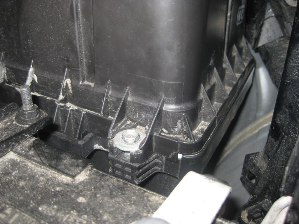

Okay, I took these photos this afternoon so you can see for reference. As you can see, the seal is tight and no filter is seen. BTW, pay no attention to the bugs....;) :lol: Hope these photos help....

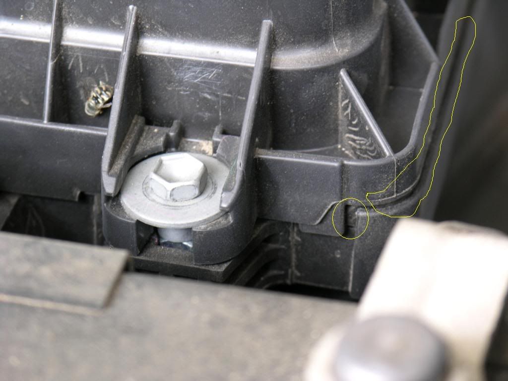

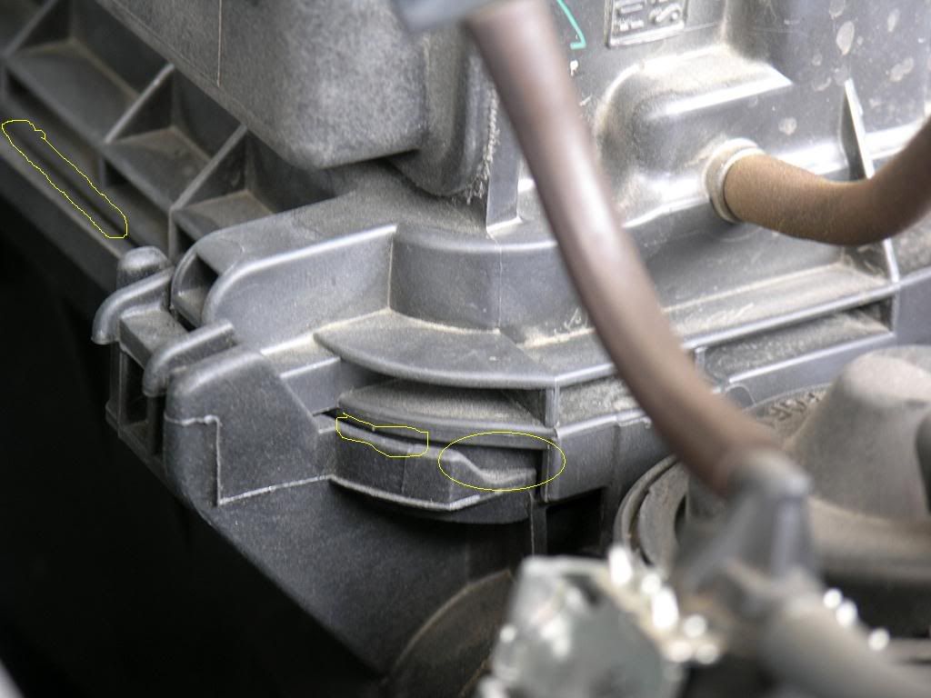

Thanks for the pics, TrailDust. I noticed that you have the same gaps that I have on mine, but on mine, you can see the stock white air filter, and on yours, it appears black. See below. I've circled in your pics where the white air filter is exposed on mine. Now, I know that you have a K&N air filter. Do you remember if the edges of the filter are black plastic? I'm wondering if what I've circled is really the exposed edges of your K&N air filter, but since the edges of the filter are black, it looks like it is not exposed? I'll take some pics tomorrow when I get home from work, since it's too dark outside now.

Okay, yes, you're correct. The K&N filter has a black gasket that runs its circumference. And, yes, now that you point it out in the photos those are sections of the filter exposed, but the good news is the filter housing and filter perform a perfect seal so you're okay. I thought from what we discussed before that the upper housing might not have been properly seated. Anyway, thank goodness for the power of photos to clarify things! :cool:

Here are the pics of my air filter box. As you can see, the size of the gaps are the same as yours, but since the stock air filter is white, it is more noticable. Like you said, the filter and housing form a seal, so I guess I'm okay. I didn't notice that the air filter was exposed before changing it, but I guess it was.
