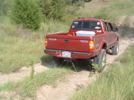

Hossmaster, you wouldn't happen to have a picture from the rear of your truck with that size tire on it would you?

will this work for what your looking for???

Nice truck hoss. Is that a factory installed luggage rack? Is it limited edition?
