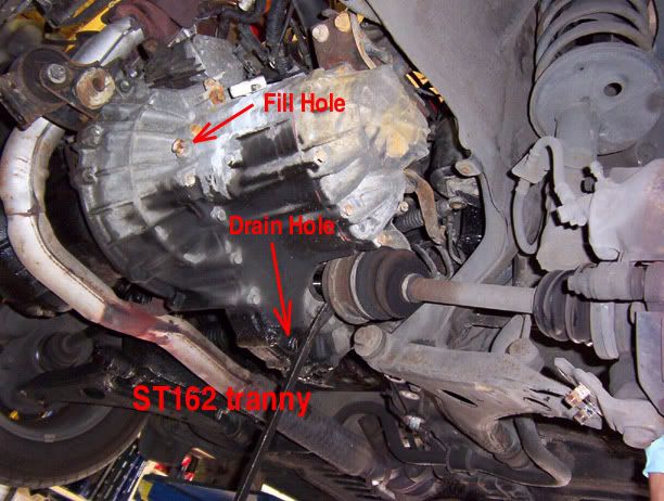

Your car is a '91 GT 5 speed. On a manual tranny, there is no distick. Only auto trannys have the dipstick.
ST162 manual tranny below, the ST182/5SFE tranny will be very similar.
IIRC, they are 22mm or 24mm bolts. Drain it all out and then refill until it flows out of the fill hole - that will be the proper oil level. Car must be level for this.
