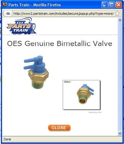

where can i get a sensor that has 2 hoses connected to it that's near the water neck on my 95 s-fe? The dealer wants 80 for this.

He means the coolant outlet housing. The part he is talking about I think is the VSV.

Here's a link to what i think is the part you are looking for. Apparently its called a bimettalic valve. Its relatively cheap too.

Is it either one of these?
First one is the bi-metalic valve, the second one is the vsv.
The first one's it.
That's the purge valve for the charcoal canister (although, as other posts have stated, for some reason Toyota calls it the "bi-metallic switching valve") -- lets air through once the coolant gets to a certain temperature, no air through when it's colder. OEM part number 90925-05068 . $80 is obscene -- MSRP is roughly $40 (just bought one from my stealership in the last month, and they always charge list, no more, no less). Should be able to find aftermarket for $20 or less...just search for the OEM part number.
