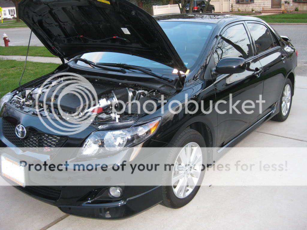

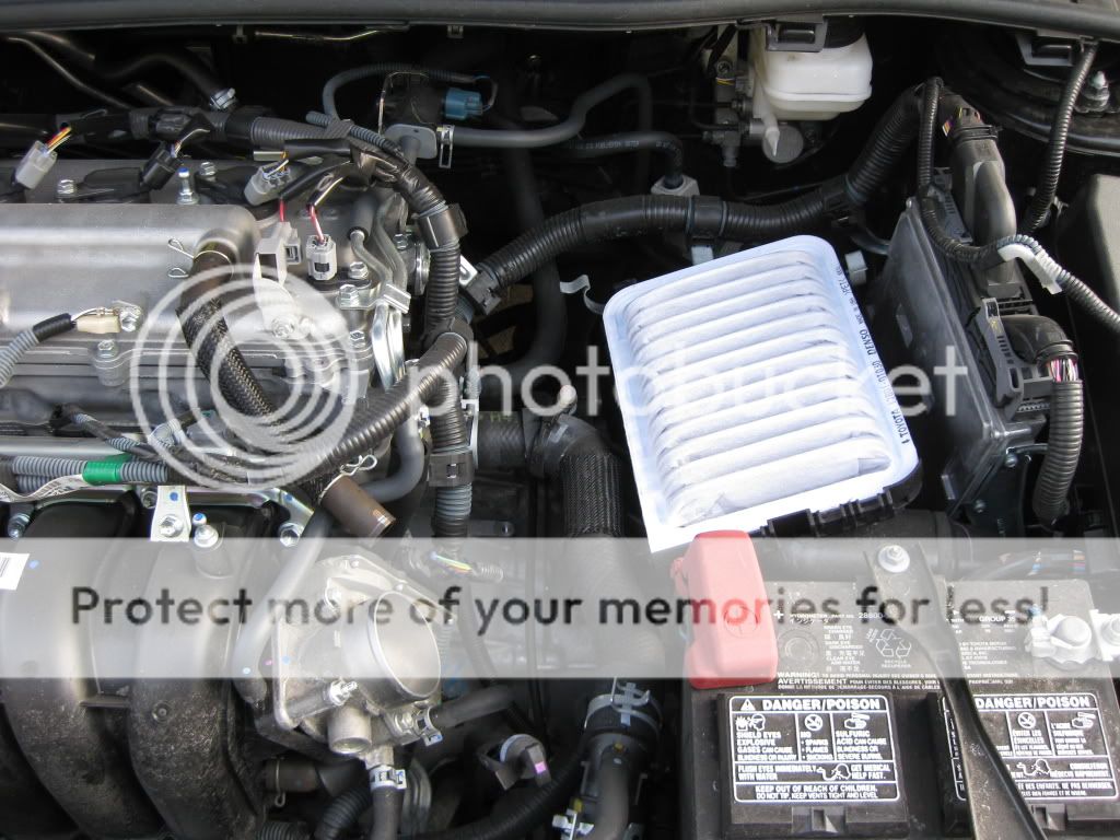

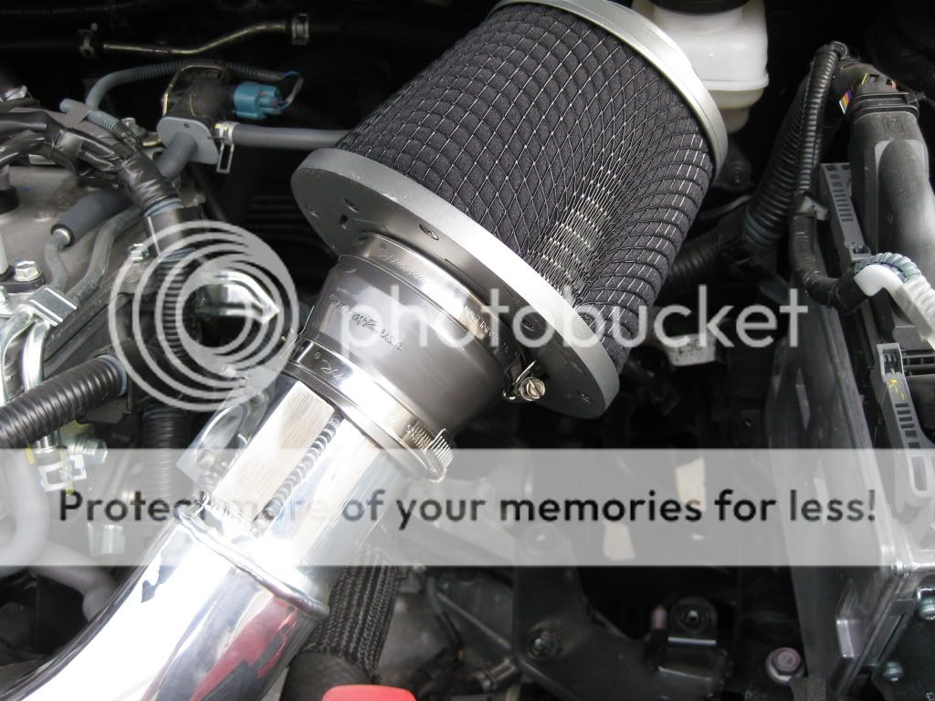

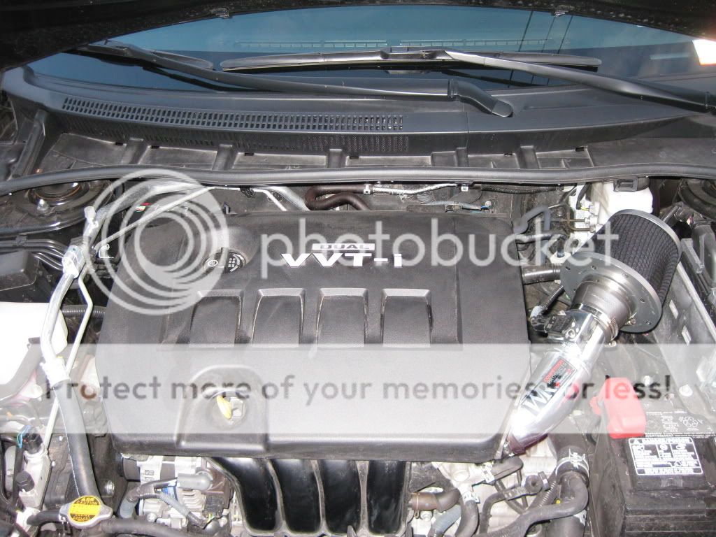

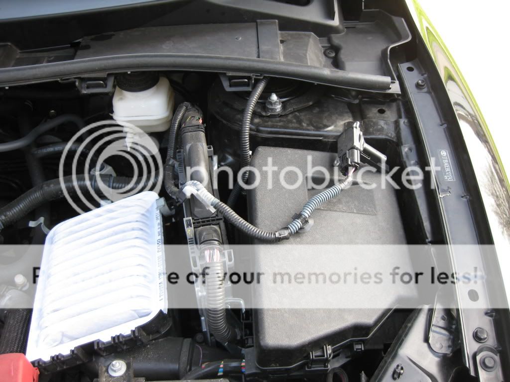

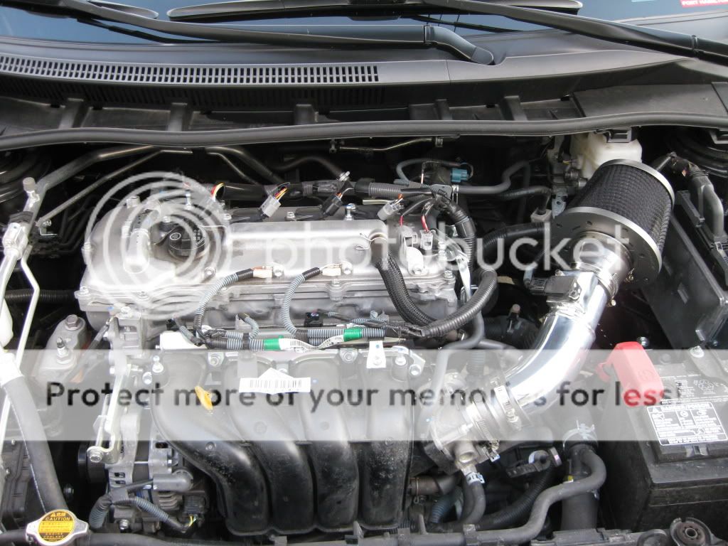

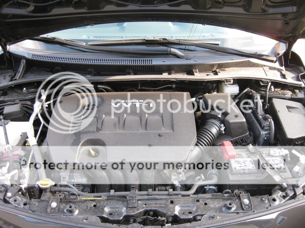

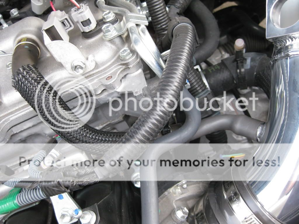

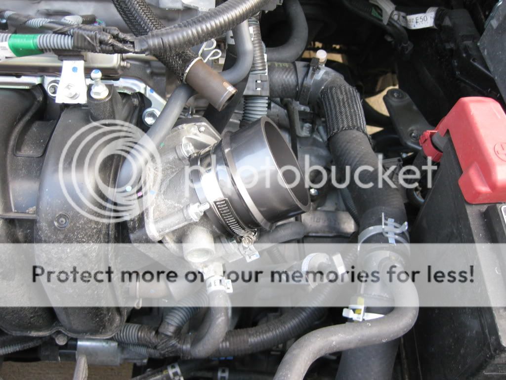

Here it is ladies and gents. . .a few of the 09' rolla owners already posted pics of their setup of weapon R SRI. but there have been many requests of pics even though setup was relatively easily. so upon setting this up, i decided t take some pics to help those out. so hope you all enjoy and please no negative comments on SRI. k thanks :cool:
My 2009 Corolla S w/ 6000K HID, 35% tints all-around, and now weapon r secret intake SRI.
So there you have it folks . . . the pics almost correlates to the same order as the directions that weapon r gives w/ the SRI package. feel free to ask questions if unsure about some of the pics, i'll be more than happy to answer. ENJOY! :D

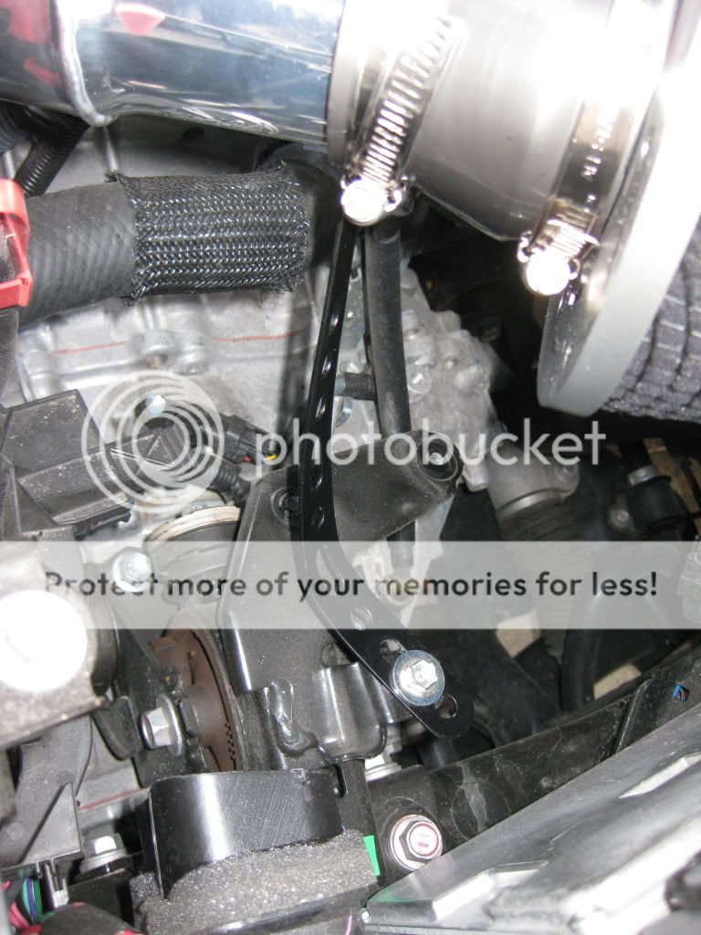

about the clamp....is the black metal strip the only mounting of the intake?

Question on clamp: Yes. That black metal strip (4th pic from bottom) is the mounting bracket used for the intake. it actually comes w/ two...but instructions on where to place was realllllllll awkward and made no sense, so i just needed one. But if you are also wondering if it's sturdy. Yes it is =)

hmm.. to answer your question. performance wise, it does have a bit more kick to it and does pick up a bit faster. mpg...well i think i'll end up burning more gas b/c of the freakin' awesome sound it makes when u gas it! :naughty: and as for check engine light..none. hope this answers it :clap:
So on the installation manual, where does it ask you to mount the intake to? And that two metal pieces are straight when they are out of the box, right? You did bend it?
looks good. It would be interesting to see how much intake air temps increase (not good for making HP). Anyone with a ScanGauge they can plug in to check the increased IAT? With the metal tube acting as a heat sink and the intake now being closer the the exhaust manifold, IAT must be substantially higher.:confused:
honestly...the instructions don't tell you where to exactly place your intake :confused: once you connect the weapon r intake pipe to throttle body, you get a good idea where you need to rotate it around. and yes, in regards to the metal mounting pieces; they were straight from the box and it's quite bendable which you have to do to get the right angle. i'm no superman, my lil bro can bend that stuff. :lol:
