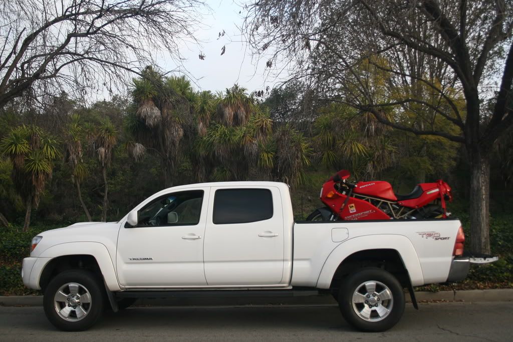

If you want to be able to handle a load. OME Dakar leafs! Best $360, I've spent.
This bike is 550 lbs, absolutely no sag!
This is with an AAL theres about 800+ Lb's of tar in the bed.
Ditto. Had 700 lbs of sand in the bed the other day, only sagged 3/4".
