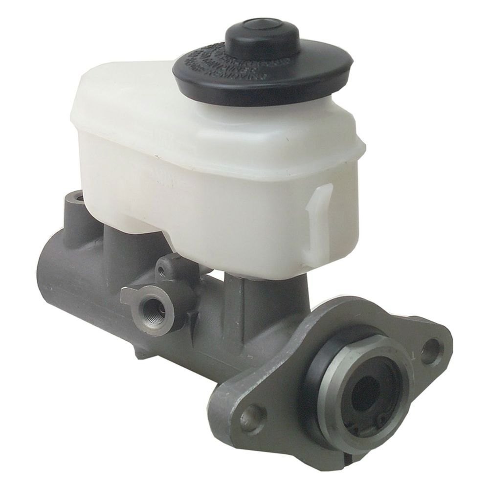

Other question. When i look for partnumber 4720133110, i see pictures with one connection on the side and one on the top rear of the cilinder.
290358
But my car has two on the side:
290359
And its original Aisin. Anyone knows difference and compatability? Or anyone knows where is aisin p/n stamped, so I can check? I did not mix ABS and non ABS versions.
Thx.
EJV

as far as compatibility, I guess it will depend on if you can bend the brake line to the different mounting point
How much you wanna bet the next generation was the same in all other ways but the outlet was moved, and someone is selling it for both generations as otherwise equivalent?

  1. Yes was thinking same about generations, but i was also thinking that maybe the previous owner installed one of a hilux or 4runner in the past because they are widely available here. The ones of the camry not. I guess it will remain a secret for now. Will check if there is room for brake line.....
    290365
Drawing shows port upwards, but is ABS version...
