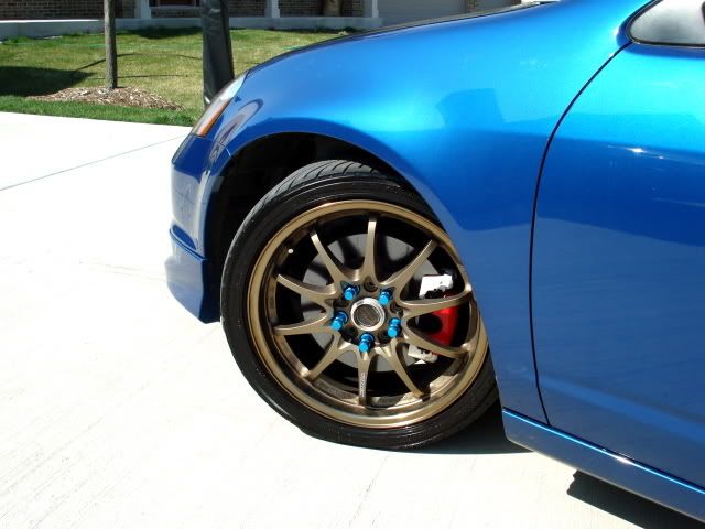

I highly recommend the Rays extended lugs.. they come in black, blue and red...
