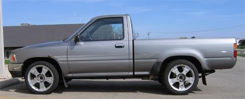

I've got a 1990 2wd which has a slight wheel wobble at around 35-40 mph.
Here's some history:
I got the truck in Sept. and it was wandering all over the road and I ended up replacing the relay rod, tie rod ends, and idler arm (which were all pretty shot). I noticed the wheel wobble a few months later and attributed it to the lug-centric spacers that were on all four wheels that the PO had put on to fit the Lexus wheels that I bought the truck with. It may have had the wobble all the time but I probably never noticed it because of the afterfiring problem I was trying to troubleshoot. I recently (about 2 weeks ago) found a set of Mustang wheels on craigslist for cheap and mounted them on the truck hoping that was the problem. Apparently, that was not the problem.
So aside from wheel balancing, which I will have done first to rule it out, what else should I check?

My truck does the same thing. i am running Lexus wheels with 2" spacers. The truck was fine with the stock 14" steelies on it and developed a wobble at 35MPH like you described after I put the spacers and Lexus wheels on. The tires on the front are badly edge worn on the inside and the rims had some curb rash so I attributed to the Lexus wheels and tires. I was almost scared to take it on the freeway as an out of balance wheel usually shakes worse at higher speeds. It turns out it smoothed and and drove great the faster it went. I threw my steelies back on and left the 2" spacers on when I parked it for the winter and sure enough it had the same 35MPH wobble. So my guess is my adapters are causing my problem. If you changed rims and still had the problem on your truck I don't know what to tell you.
