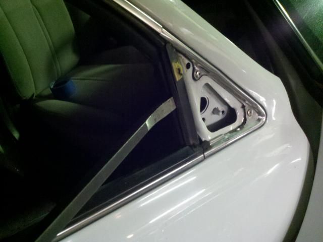

52 Posts
YES!!! YES!!!!! I used the search button, found this thread from 2010, and this worked!!!
I just bought a 96 Camry wagon..it was kinda beat up but at the price I paid I could live with the fixable problems.
This problem was on my right front passenger window. Took the door panel off and noticed there was a lot of play/slop on the plastic guides on the regulator. Thought I had to replace the regulator. To be sure, I came on here and found this thread. After reading this, it explains why the holes around the mirror bolt have chipped paint and noticed broken glass when removing the door panel. Someone [email protected]#?#$#@~#@ this door up at some point. Bastards!
Anyways, here's what you'll need:
8mm socket
Thick flat head prybar.
**Not sure if this can be done with the door panel on but mine was off anyways to inspect this problem. If you do, you'll need all the tools necessary to remove door panel.
Here's what to do:
- Roll window down
- On the inside front of door pull off black garnish plate behind mirror. It is held onto the door by three clips. (blue arrows point to holes where clips go into)
[/URL][/IMG]
- Remove the three 8mm bolts. (red arrows)
*if you do this with the door panel on, you will have to let mirror hang by wire (don't recommend) or just don't remove bolts all the way.
[/URL][/IMG]
The black part circled in yellow is part of the rubber moulding over the metal part of the door. This is the area where it's probably pinching the window as it rolls up. I think this bends in a little if someone bumps into the mirror.
The prybar I'm using is wide and stiff. Not sure you can use a wide flat head screwdriver. All I did was twist is back and forth like a screwdriver to widen the channel. Do this from the top to the bottom.
Roll the window up and it stays on track all the way!!!!
Thanks TN!!!!!
