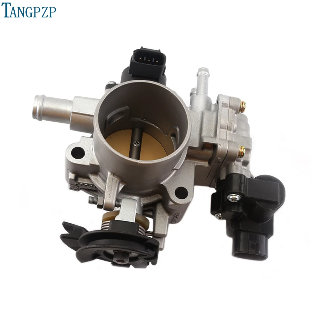

Hey guys ... It's sounds hilarious that I just took it apart for no reason 🤣 but I do really need help on how to put them back together 😭... Please give me a guidance...
Car: 2001 Toyota Corolla S 1.8l 4cyl 1zz engine
#2 ·
Looks like you will have to hook the spring onto the cam, and wind the spring so the the throttle plate will return to the closed position when released.
I don't recall any FSM telling you how many turns to wind the spring, but you might remember the amount of tension before you removed it. You can also go to the junkyard and either get a used throttle body or examine how much tension they wind the spring.
This video (and maybe many others on YT) should give you some clue:
