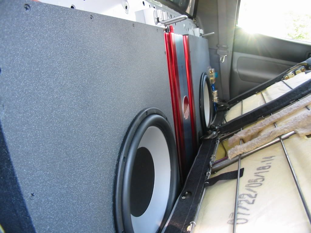

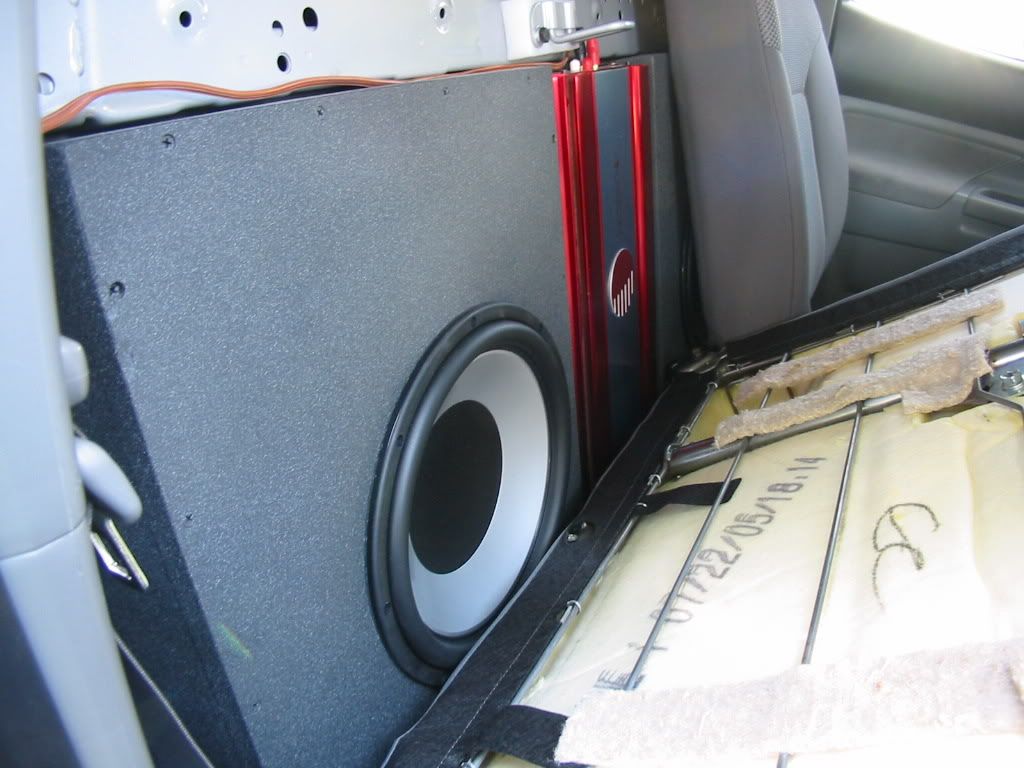

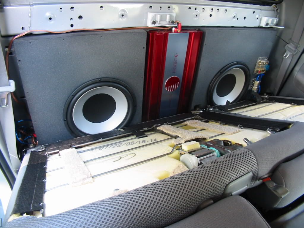

Completed new sub box with two Image Dynamics 12's powered by an Orion HCCA 250G4 (800x1@1ohm). Next is the Morel USA SR-8.3 3-way components in the front doors powered with a Phoenix Gold MQ430 to the tweets and mids, and another Phoenix Gold MS275 to the mid-bass drivers. All this is going through an Audio Control 4XS crossover. So far I have the Orion and subs hooked, and with the factory speaker crossed above 225Hz - it plays very loud. Can't say too much for the SQ up front though. The Morels should take that up a notch. Although I don't necessarily recommend trying to squeeze 12's behind the rear seats of the double cab - it can be done. See some of the sub box construction and drivers here:

lets get a picture of that beast in there! lookn good man.... thats alot of fab... id love that but i think im satisfied with my 1 10w6 enough to not spend that much time on it.... thats just my opinion though... make me one if you can... thatd be greeeaaaaatttttt yeeaaaahhhh (office space) good job tho lookn good

Yea that looks awefully close to the seats
There's actually more than enough room there. Notice the AudioPipe distribution block (used for the ground back to the battery) in the first picture. That thing sticks out 1-1/2" and doesn't hit the seat. These ID12's have a 13.5mm(0.53") one-way Xmax. So even at full pop, they have at least 1/2" of clearance - even at the top where it's the tightest.
You bring up a terrific point though, as this was a critical consideration when designing the box. I could have brought the face of the box forward if it weren't for the way the rear seat-backs hinge. As you lay them down, the leading edge gets closer to the back wall. It is very tight when the seats are laid down, and that's the only reason I had to remove the plastic covers from the seats. With the seats upright and locked, the driver still has plenty of clearance - even with the plastic panels installed. But the plastic hits the driver surround when the seat is laid down.
You will also notice that I have spaced-out the seat lock tabs with 1" thick UHMW and longer bolts. This also serves to improve excursion clearance, but is not the reason for the spacers. I needed the spacers to get the proper box volume while allowing for that clearance. Again, the clearance issue is with the lower section of the box when the seat backs are folded down. That is the limiting factor for depth at the bottom. The spacers allow the top of the box to be deeper - providing necessary box volume that you can't get anywhere else. Building out, into the side pockets and up in front of the upper support beam don't provide any volume once you factor-in the 3/4" MDF board thickness, so there's no help there. If you’re going to get it, you have to get it from the upper section of the box.

The paint finish looks great.

The Image Dynamics 12" 4 ohmDVC OEM Overstock drivers I used ($120 for both delivered directly from ID off eBay) are 5-3/4" deep, but that depth is measured to the very end of the magnet - which has a 1/2" protrusion with approximately 2" diameter. By controlling the angle, I was able to 'gain' front/back clearance. Also I used a Dremmel to rout-out a 1/4" depression in the back wall of the box so the magnet would clear.
Here's what I did... I laid-out the driver - transferring the profile to a piece of cardboard. Then with the cardboard cutout (representing a side view of the driver) I started playing with angles and locations. Eventually, I realized the driver would have to be mounted as far toward the bottom of the box as possible (where it is the deepest), and angled in a way that provided the most clearance. When I realized the magnet would need to go into the back wall by less than 1/2", I knew I had a winner! As it turned-out, I only had to carve 1/4" depression for the magnet. Warning! I also used 1" UHMW spacers on the seatback anchors to bring the top of the box out beyond where the seats would normally lock. I would have been into the back wall of the box the 1/2" (mentioned above) had I not done that. But the purpose for the seat spacers was to get more air volume - not for speaker clearance.
If you ask me if a 5-3/4" deep driver can fit... I'd ask you, "What's the diameter of the magnet?" If its small (<2"), or even just small at the spot where it would hit the back wall of the box... then "Probably". If the magnet is 6" full depth... "Probably not". Then again, a 10" driver has some other possibilities. You may be able to get more creative up higher in the box than I could - possibly angling the driver so it fires up at 45deg to gain more depth.

On airspace... these 12's require 0.70cu. (1.0 optimum) each and displace 0.07cu., so combined they need 1.54cubes (2.14 optimum). The internal dimensions are basically 17"Hx7"bottom (2.5" top)Wx47.5"L. After adding for the angled top (see the pics) and subtracting for the amp rack, back wall bridge, seat bracket pocket and internal bracing, I get 1.828cubes. So it's somewhere between the 'minimum' and 'optimum' air space. With a (theoretical) 10% adder for abundant polyfill, I arrive at 2.011cubes - dangerously close to the optimum 2.14.
