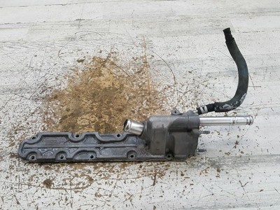

Looking for some info on this plate beneath the coolant bypass hose where the knock sensors are. I’m replacing both knock sensors and the bypass hose. The bypass hose had no signs of coolant leaks so I suspect the plate is leaking coolant. Attached is a picture before I cleaned up the coolant residue and another after I cleaned it up. The camry has 250,000 miles…out of all the videos I watched on youtube, nobody bothered with removing that plate.
1. Does the plate even come off?
2. Has anyone tackled the job?
3. Any tutorial or DIY anywhere?
4. What are the torque specs of those bolts?
5. Which bolts do I even remove? All?
6. Is there a gasket? If so, whats the part number for it?
Thanks

Hmmm… interesting. I’ve never seen anyone mention removing that plate, so I’m not sure if it’s removable or what’s underneath it. Looking at exploded parts diagrams of this motor, I don’t see it shown as a separate part.
Yup its removable. Apparently there is no gasket but sealed with Toyota’s FIPG RTV sealant. Seems to be prone to leaking eventually
someone is selling a used one on ebay:
Also here is some info from a different car (same engine):
Just need to locate torque specs now……

Yup its a big job and you would be stupid to not reseal that thing after all the work to get to it and its only FIPG sealant. The sealant is really good but eventually it wears out. Cant believe none of the videos I watched about the knock sensors, nobody mentioned that plate. Looking at your photos it looks like the torque spec is 69in-lbs with a specific sequence. Appreciate you finding those! That helps!
If you plan on using FIPG then you might as well get the Toyota brand.
Part number is 00295-00103 available here and other places as well.
FWIW I'm pretty sure that Permatex Ultra Black is equivalent, but I have no concrete facts to prove it one way or the other. It costs about half what Toyota FIPG costs as an added bonus.
