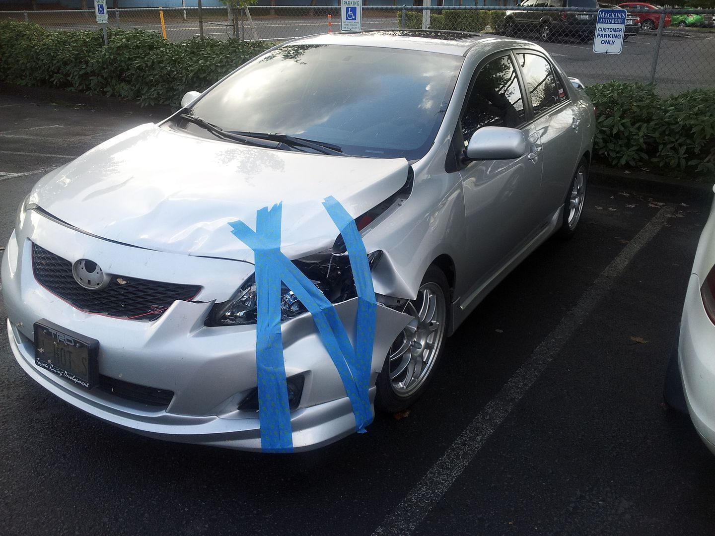

Someone at grocery store parking bumped me at my car while I was away.
May I know how much cost i am looking to get repair?
damages i saw were front right side fender/bumper damaged. i also saw leaking windshield fluid so that might got damaged. hood seems little off (not sure). right side lights seems to be fine. there were no fog lights.
I tried contacting grocery store for security camera. They will let me know end in couple days. might have to do police report.
thanks
yes, going through insurance but my deductible is 1000 :frown:
I visited police station and filed a complain and police will look through tape.
If they wont able to recognize car then it depends on how much it cost.
if it costs around 1000-1500 then i would do it myself instead of bringing my insurance guys.

From what I can tell, you'll need a new front bumper cover as well as a lower front grille, new windshield washer fluid tank (as well as any other lines that could have been damaged), new hood since you said it may be bent, and possibly a new headlight because the mounts could be broken (possibility since it looks like the headlight is pointing down). From looking at the picture, the gap between the hood and fender shows that it could be the fender that is damaged instead of the hood (could be both).
Now, with all those parts plus the parts being painted and bought from a Toyota dealer, it could cost anywhere from $1,000-$3,000. Remember, I'm basing this off of a worst case scenario where all of the parts that I have mentioned are damaged and need to be replaced. Let's hope the idiot who hit you gets caught and pays for the damages.
