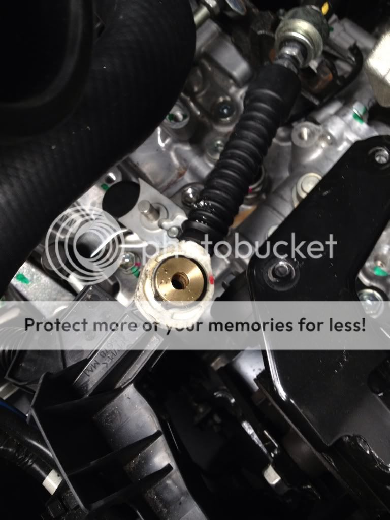

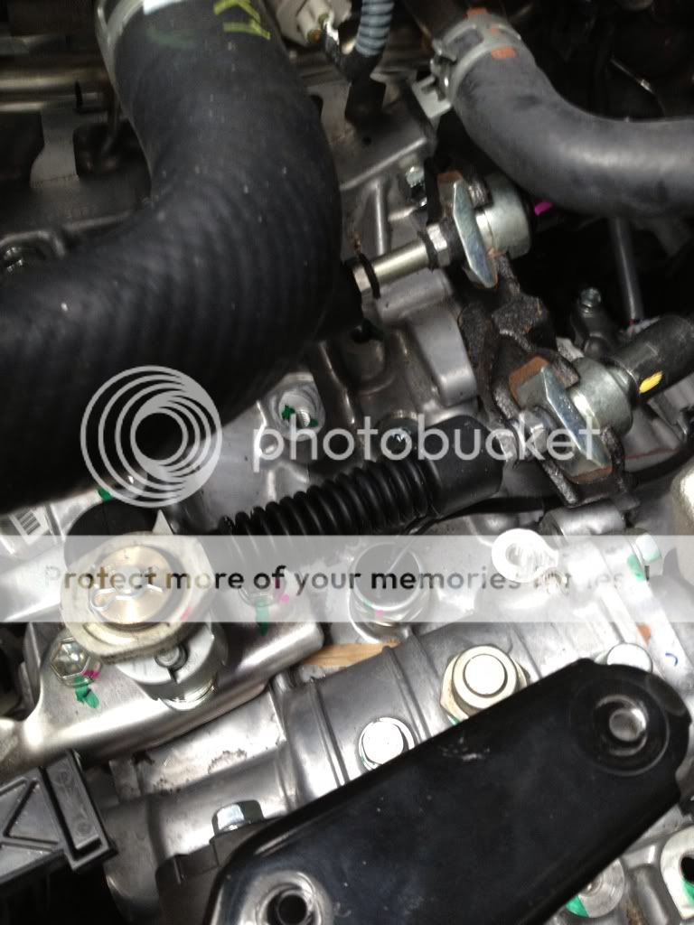

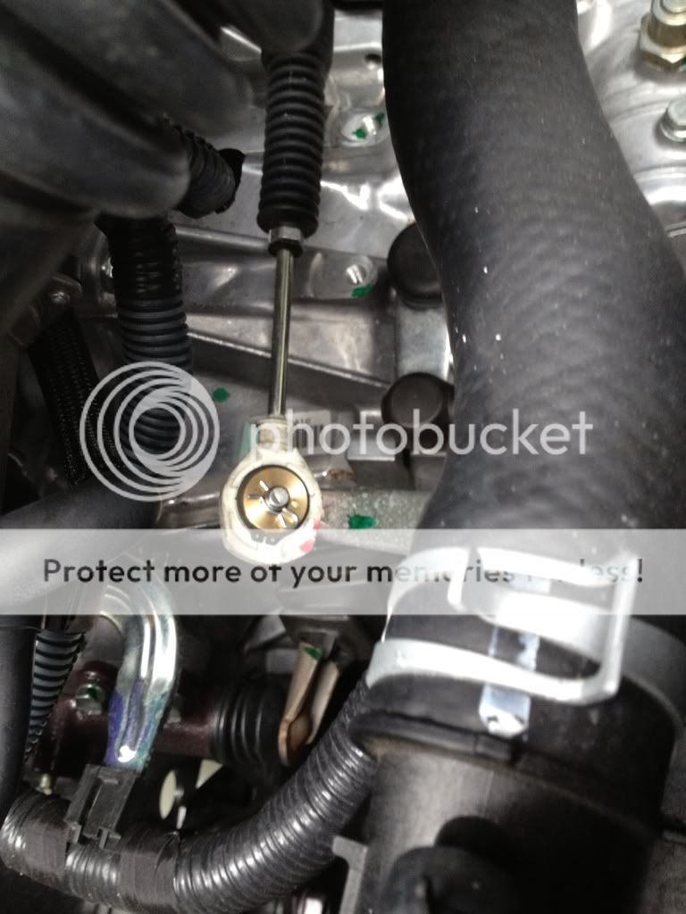

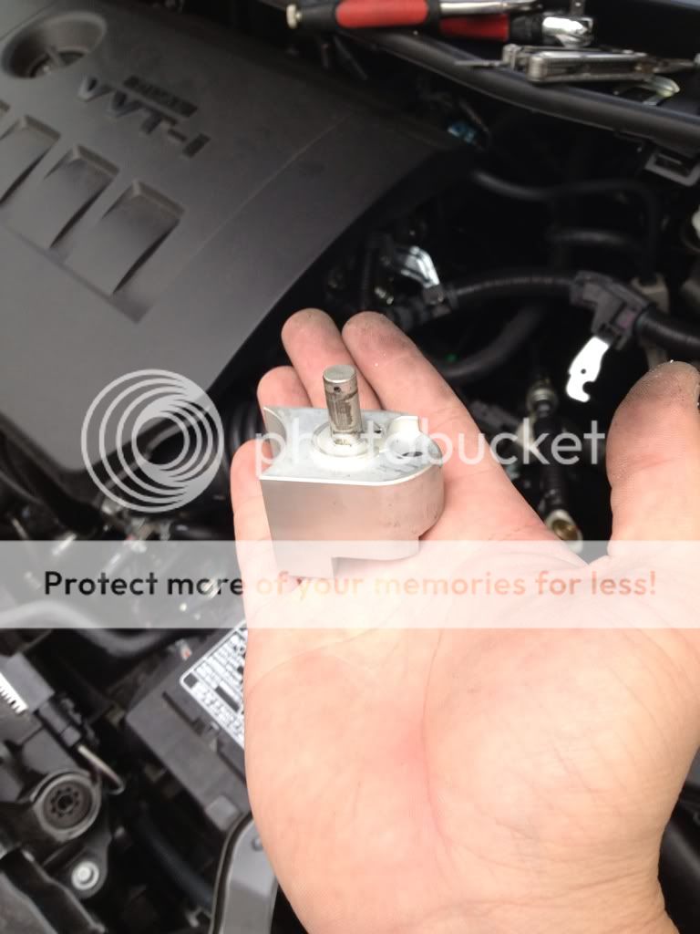

- remove airbox for easy access.
- remove pin that holds the stock cable bushing.
- place the brass cable bushing and MI-SS and your good to go.

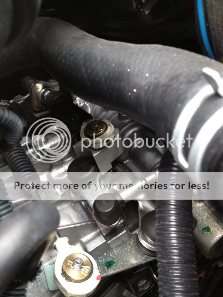

Ok..while you have it apart, do this. Drill a 1/4" hole 1" away from the original pin. Tap it with a 5/16"-18 tap and mount it like the picture shows. This will cut your left-right movement by roughly 50%. Yeah, my car is a bit crispy. Welcome to Ohio weather, salt, and brine on the roads. Does wonders for a car.

On my car, the cable end is plastic and the stud on the transmission linkage is steel. When you shift gears, make sure the pivot point is the center stud and not the plastic cable end. You should not see the brass bushing rotating in the plastic cable end. When you drop the bushing on top of the stud, it should have spun freely. This was how the original rubber bushing was set-up.
If it is spinning on the plastic cable end, it will make it hard to shift and will wear out the cheap plastic in a short amount of time.
