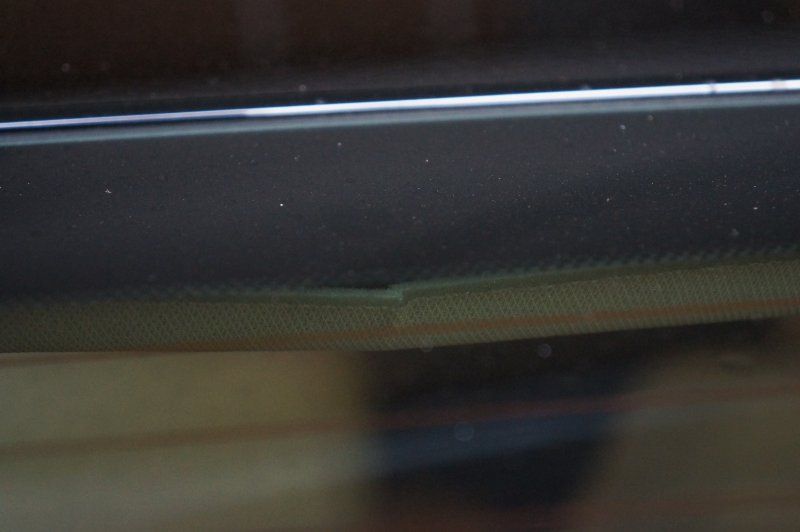

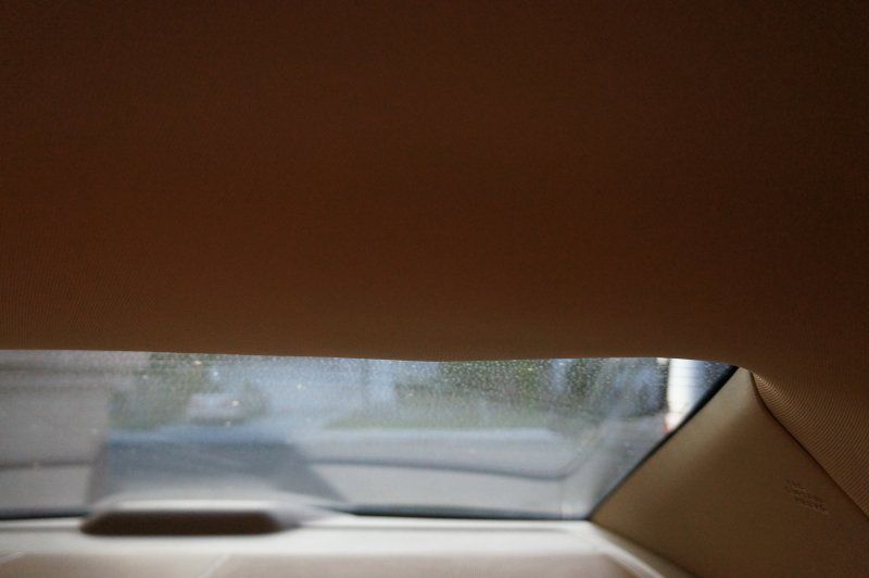

My Avalon is showing a sag of the headliner as well. It's on the rear driver's side, though the sag is not that pronounced, maybe a finger's width. I fear over time, it'll get worst.
view from outside: http://i1365.photobucket.com/albums/r743/OpticsZ/fromoutside-DSC09187_zps298996a9.jpg
view from inside: http://i1365.photobucket.com/albums/r743/OpticsZ/frominside-DSC09186_zps256ec587.jpg

Optics,
Is that a spot drooping at a seam on the outside view pic??
