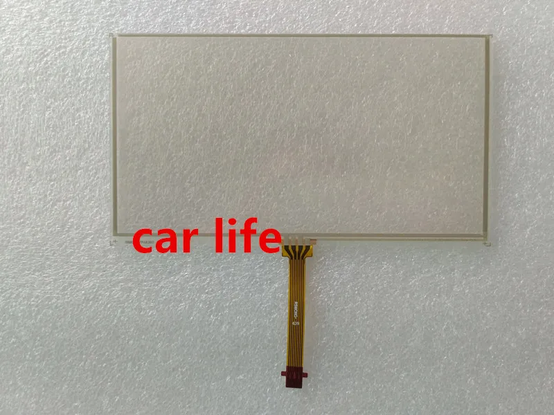

i have fixed it myself last year on my 2014.5 camry. the digitizer (part #LA061WQ1) is the issue. the digitizer is a piece on front of the lcd that detects touch. you dont need a new lcd. replacement should fix it and no calibration needed. Part cost is around $20 or less from asia. If you're willing to wait 4-6 weeks you save a lot. otherwise google LA061WQ1 on ebay and you find them for $60-100. you need to pull out the head unit and start separating things by unclipping and pulling the ribbon cables. aliexpress link where i bought mine below. it's cheaper now when i bought it last year at $18+shipping.
by the way i've seen people try to fix digitizers with a heat gun along with the edges. so you can go that free route first. be sure to separate the digitizer from head unit first before using the heat gun trick. that may or may not fix it for you. you can do it while you wait for your new one if you have a lot of time on your hands.
