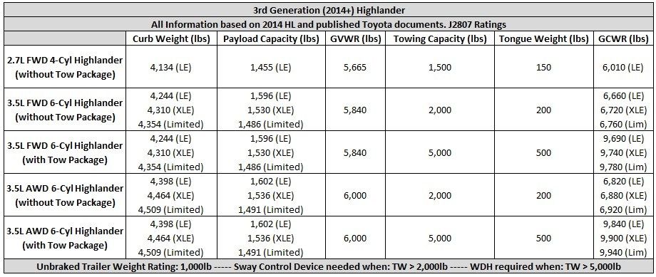

Hi. Is there anything I can physically touch or see that determine if the tow package was truly installed?All the 2016+ V6 models have the tow package,The plugs are already present to accept the pigtail that extends to the trailer you'll be towing.
