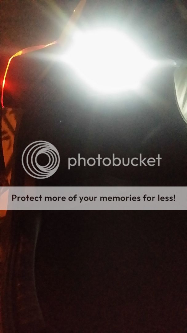

The trunk light:
Pry on the side towards the plastic housing:
Unclip the harness and remove the assembly:
Remove the cover to access the bulb by using a small flat head screwdriver
Pry down slowly not to break anything
Now you see the bulb
Already replaced and tested)
Here is your end result:
