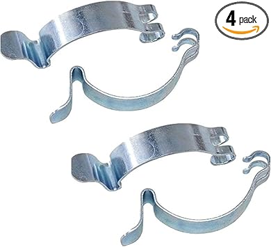

My used 2005 had a broken "pin" on the air filter box. My Toyota dealership said Toyota doesn't offer the replacement clamp. I drilled two new holes and used the shaft of a pop rivet for the new "pin". Then, after ordering a few versions of clamps from Amazon, found this to be the perfect fit. Various versions look the same but the space between the two "claws" of the clamp makes a difference.
Went to the junkyard to grab a blower motor and the airbox clips/clamps. Upon inspection, I see that the pin on mine is also broken. I’ll have to do what you did.

Good luck! My repair worked great. I got the idea from the YouTube I've linked below. You can use any sort of shaft you might have in your garage. Carefully plan where you want to drill the holes relative to where they were originally. The fellow in the video recommended things like a finishing nail but I realized I could use the shaft of an aluminum pop rivet. I bent a 90 degree angle on one end first, inserted it into my newly drilled hole, and then by holding the other end with a needle nose pliers, very carefully bent the other end about 90 degrees so the shaft would remain captured. It is important to keep the pressure while bending off of the thin plastic - hence the two pliers technique. I also had to carefully close the gaps on the "claws" on the clips I got from Amazon a bit so the clamp would remain on the shaft when unclipped. PS not all clamps work on our box and I had to order a few varieties from Amazon. If you have one from the salvage yard, you'll be good to go. Otherwise I linked the part in my other post. Let us know how it works out!
