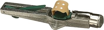

As far as belt squealing goes, besides proper pulley alignment, make sure the pulleys are free of oil (I use an old toothbrush and alcohol to clean), and that the tension is correct. Gates has a simple gauge to help adjust the tension.
