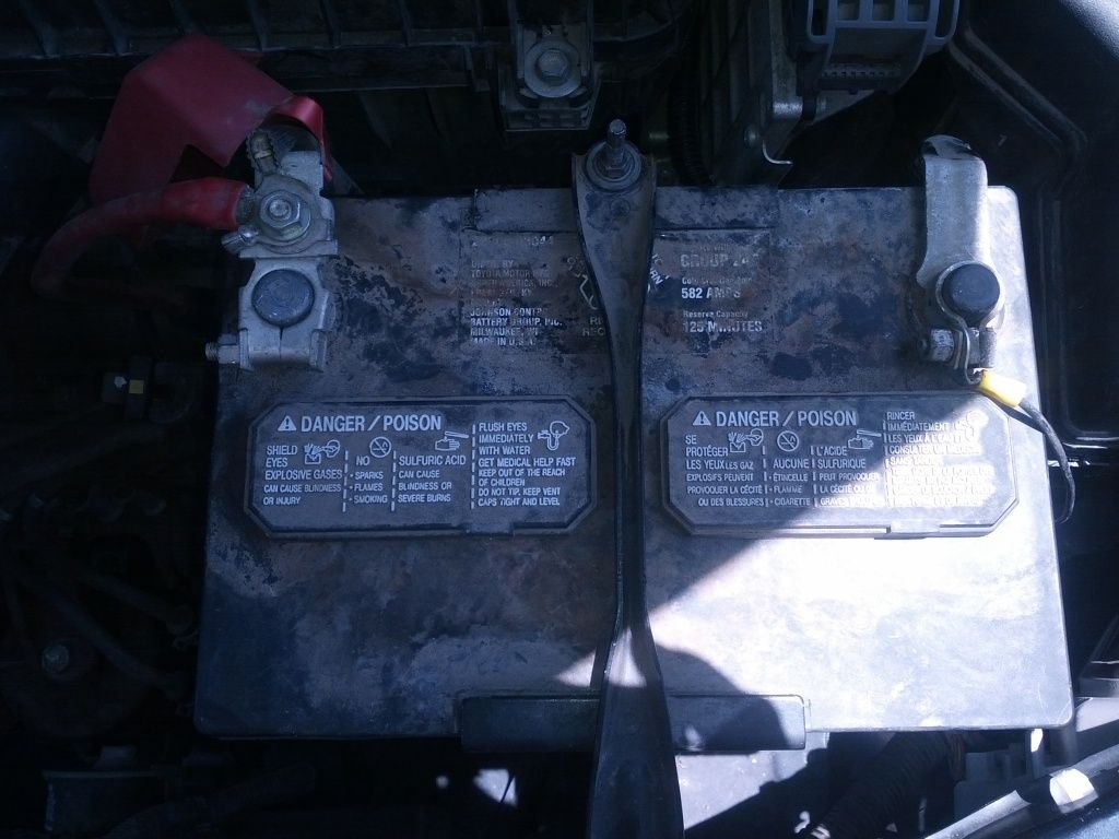

I did my biggest screw up today:( I went to hook up a new battery and didn't notice the terminals were opposite of the old one. I hooked up one and as soon as I touched the other terminal it sparked and the horn honked. I straightened it out but now the car won't start. I checked all the fuses and found one blown. Changed it still no good. What should I check now:(

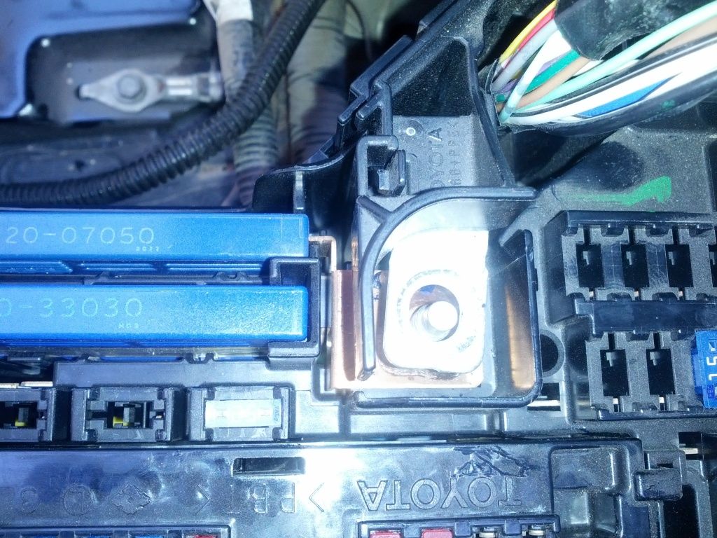

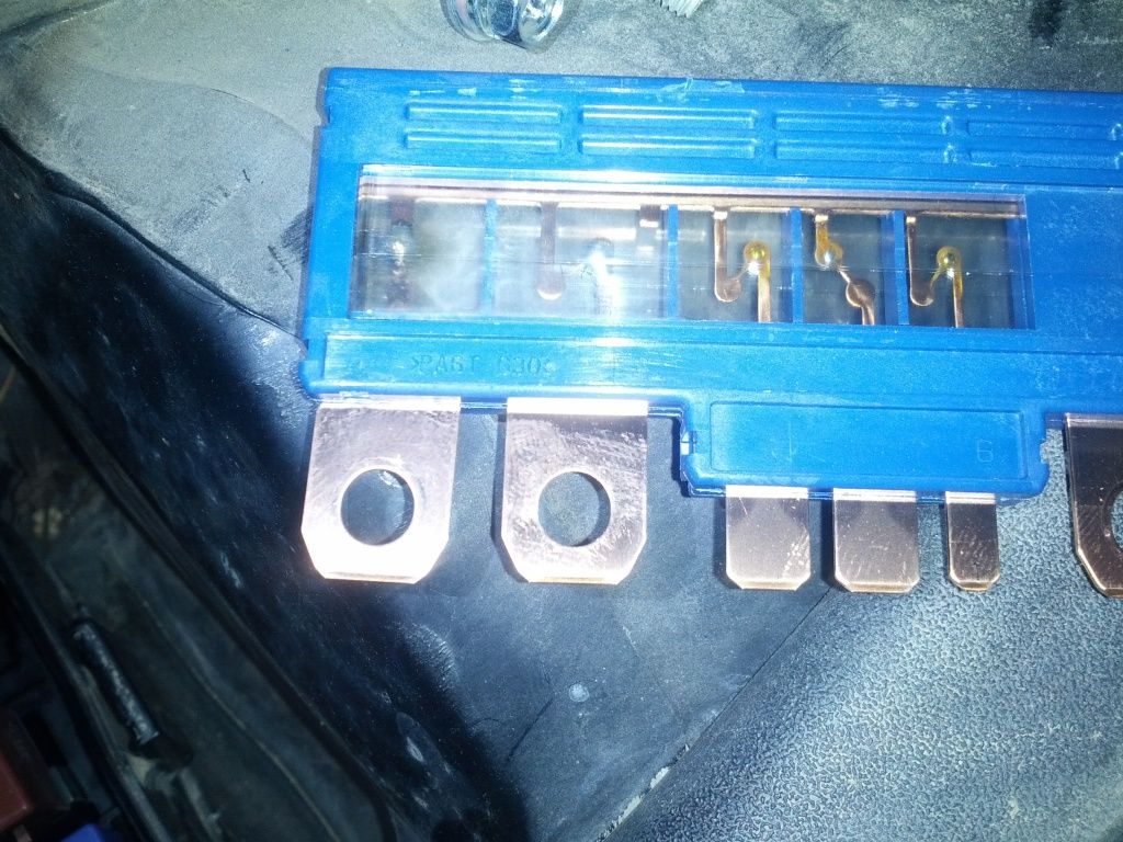

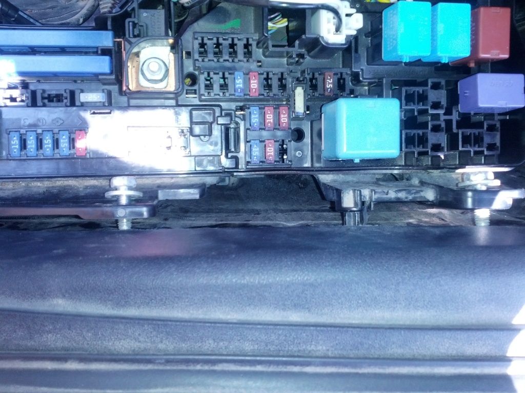

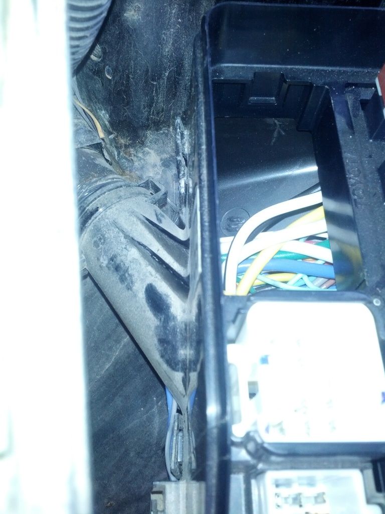

Where under the dash-- I will get out the book. This is a gen 6 by the way-- where is the 120 amp, I checked the fuse and relay box didn't see any thing that big unless it is the blue bars in this pic, How do you remove these? A tug with some pliers didn't do anything.

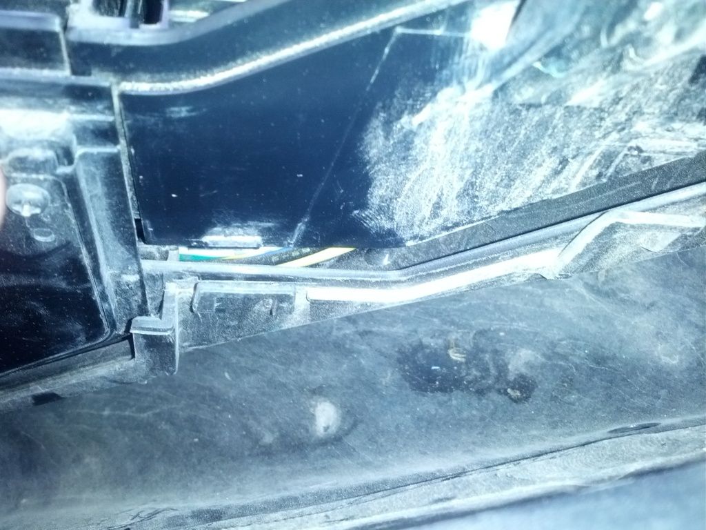

Look under the dash at the coin holder, you will have to lay on your back.

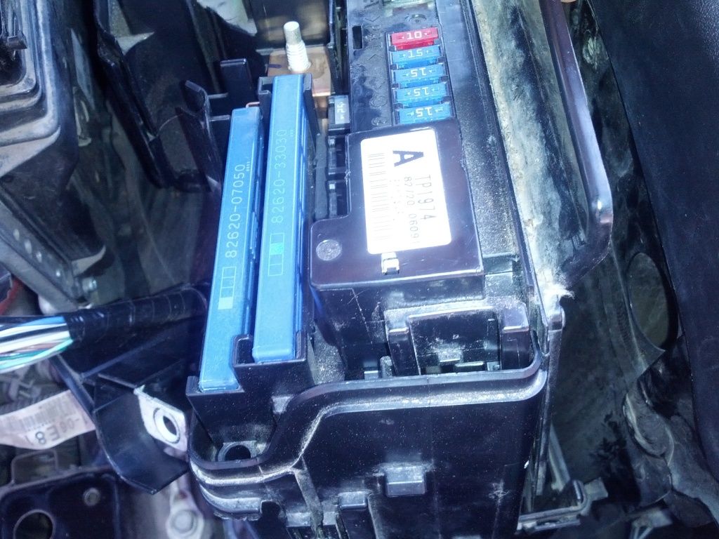

The 120 amp fuse is the 82620-33030 numbered one. The car will start with this fuse open, but you will have weird symptoms on the dash and the battery will not be charge as the alternator isn't connected to the battery.

Upon further inspection with a flashlight at multiple angles the 33030 does have the first junction blown. I changed a 10 amp fuse It was one of the ignition fuses under the dash. It will now start with my remote start but not with the key. I have dome lights and dash lights. No headlights etc, no power seats or ac, and the car won't go into gear. The abs lights are on the tpms light is on and the outside temp says E.

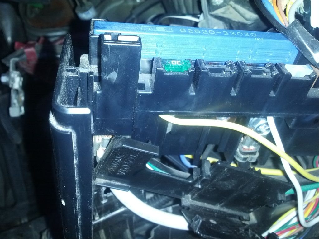

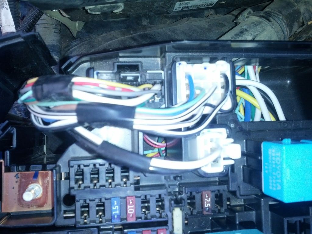

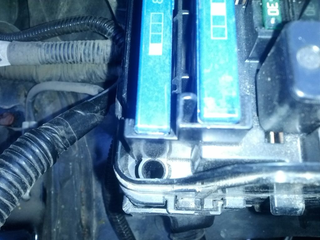

If your talking about these fuses

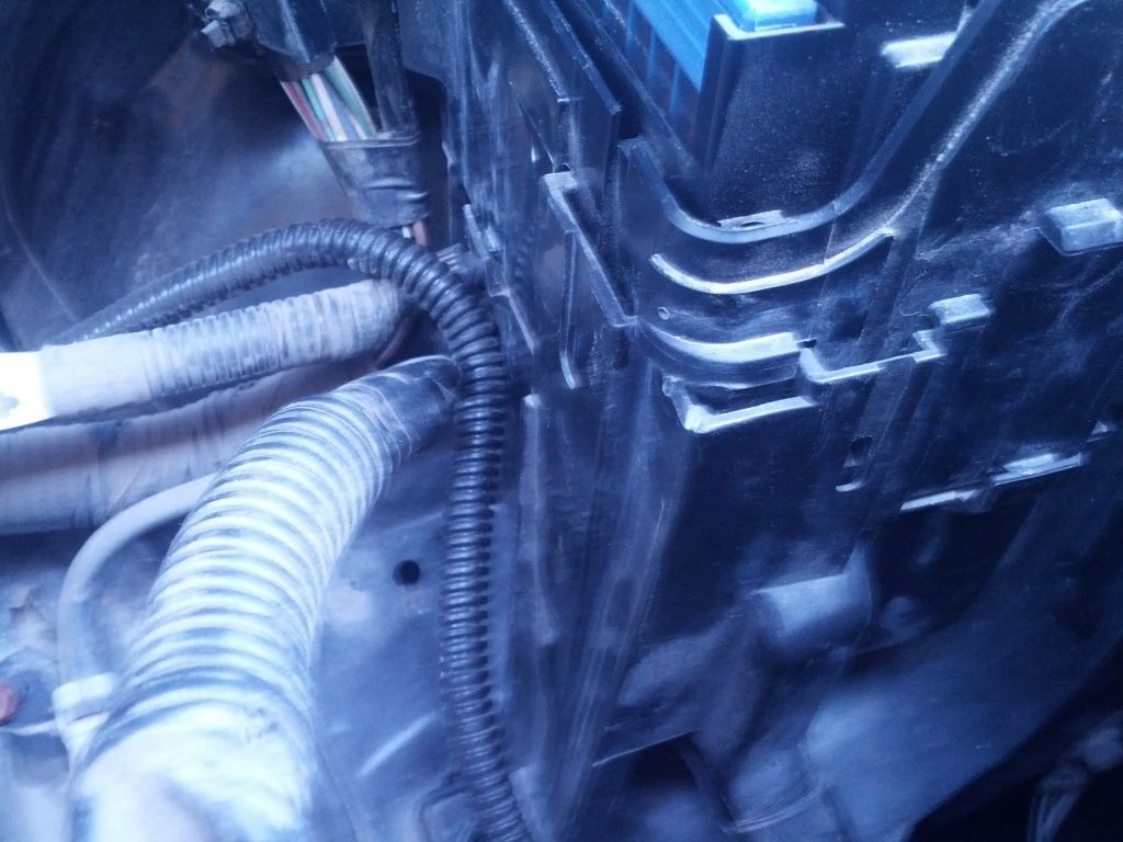

they are dealer only. Autozone, advance auto, walmart, etc none of them carried that tiny fuse. Though my dealer didn't charge me for new ones (which is always a plus), you might get lucky.
I couldn't find them locally either, I used a standard mini till I could get the correct ones, just couldn't put the cover back on.
I bought a complete kit (all sizes) on flea-bay, in my trunk now.

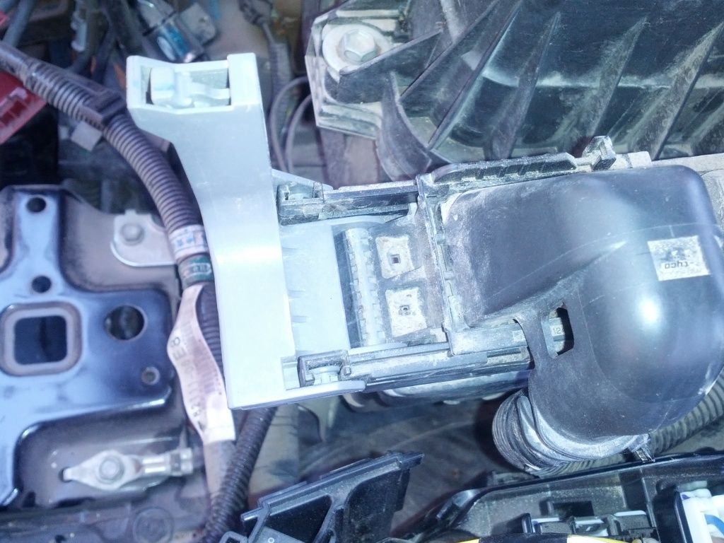

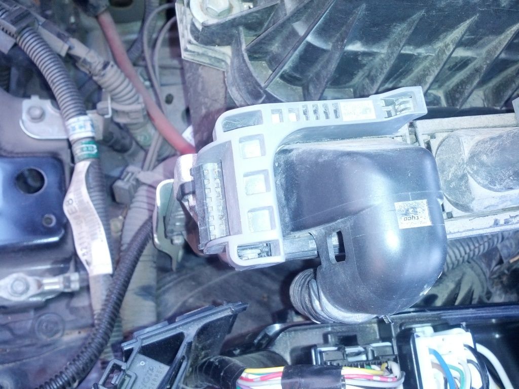

Yeah my local dealer confirmed the dealer only, He said he has a bunch of those in stock. I don't know about the price for them. The big bar fuse he will have in by 8am tommorrow $22 and change so that is not as bad as it could be. I will let you know how it goes when I get the parts and swap them out. Any big things to worry about with taking apart the fuse block? It seemed like just the one bolt in the block itself then some plastic snap together action?
Disconnect the negative cable from the battery and leave it loose till you are complete with the fuse change.
