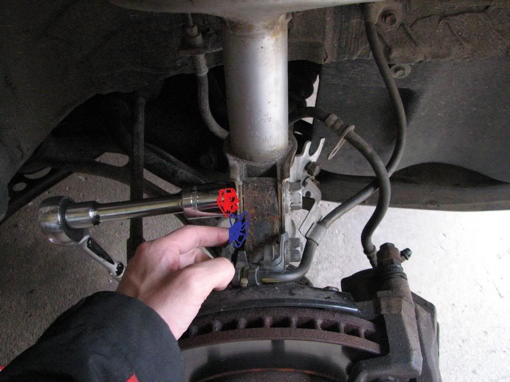

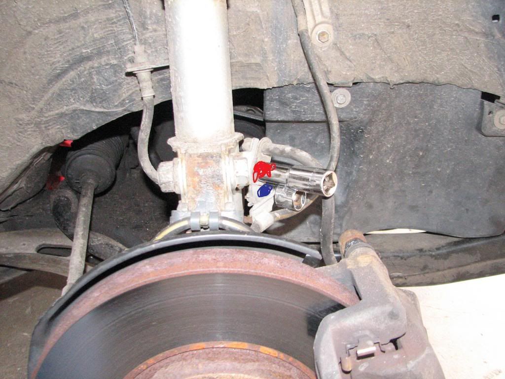

4: Chances are, you will need a breaker bar. Unless you want to get a hurnia, which I almost did......Bloody hell that freaking sucked. USE A BREAKER BAR! Like $20-$30 at most auto stores. Unscrew the 2 nuts as seen in the picture below.

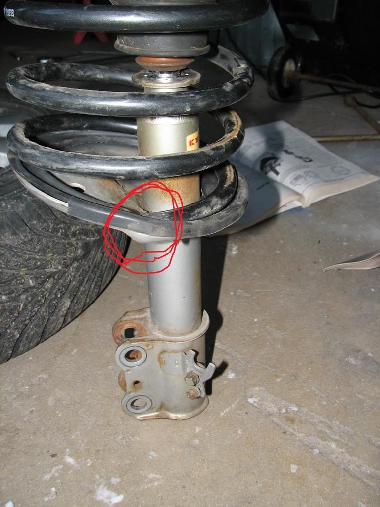

7: Unscrew the compressor and compress the new spring the same way as this one was to be remove. when putting the new spring on the strut, make sure the bottom end of the spring sits securely in the notch in the strut as shown before.

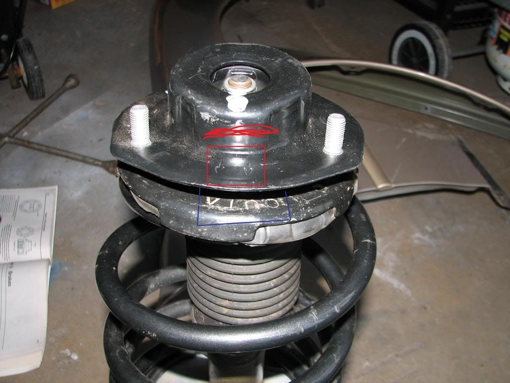

8: Line the grove on the mount up with the notches on the tip of the strut screw. You will know what I mean when you see it in person. Twist the strut mount around until you are 100% sure it is seated correctly on the notch. Then screw the center nut back on.
9: See that the Strut mount and plate are aligned correctly as show below. The plate needs to be correct when the spring is un-compressed, but the mount can be moved afterwards.
