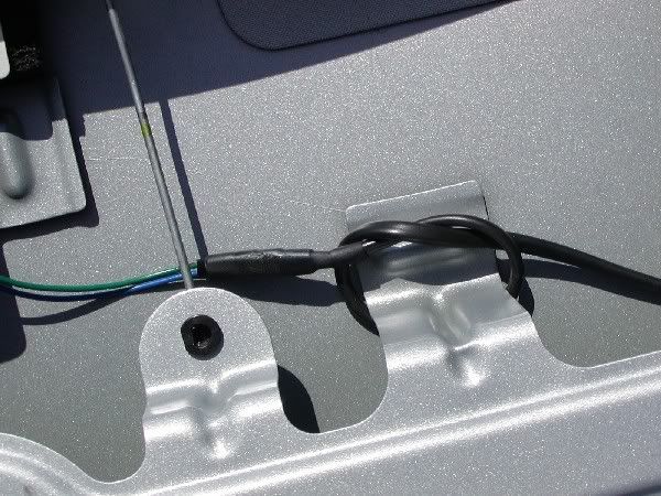

2) One of the “ghetto fab” issues is that everyplace Dynolock stripped the wires it looks like this:
Because of this issue I cut and restripped all the wires. I couldn’t find bullet connectors to match so I used these on the connection between the actuator and short harness:
I would just solder some good connectors on this one if I had it to do over again. I used these and it was effective but soldering and heat shrink would probably be better.

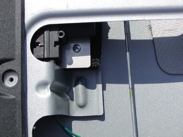

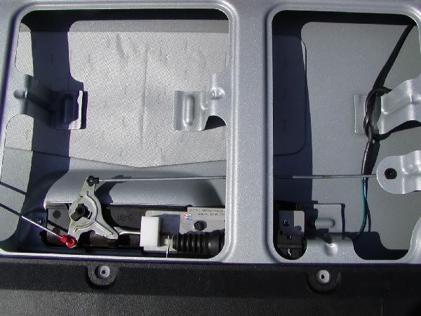

4) My bolt and spacer worked without modification. I was very disappointed in the fact that the actuator installs with a single bolt. It is shaped and sized to “friction fit” in place but it just seems to hang there. I put a piece of rubber stall mat (for horses) about ¾” thick under the other side to support it and secured that with a screw (just into the rubber - not the tailgate).
5) As someone else has mentioned, but wasn’t clear to me in the instructions, the assembly order is supposed to be, tailgate, spacer, actuator, lock washer, bolt.
6) You’ll have to wait until you get the unit working to make final adjustments. It’s definitely got some fiddle factor to it. If you don’t have it aligned right the actuator may not deploy correctly which can cause the unit not to lock or interfere with the opening mechanism to the extent that the handle won’t release the tailgate latches whether or not it is locked.

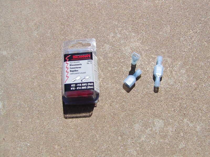

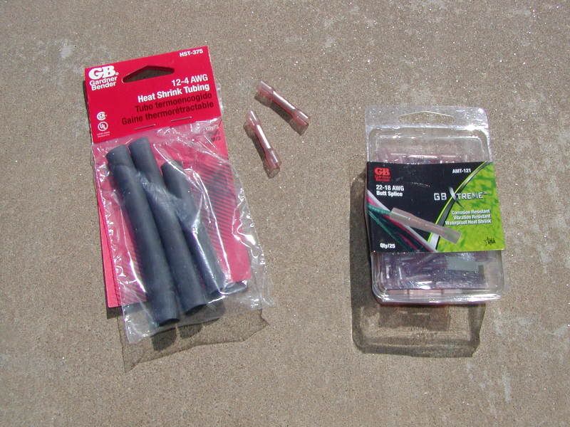

8) Because the connectors had to be changed I used these:
The pic shows the blue one demonstrated, but the red is the right size. I’m crimp connector challenged (http://www.toyotanation.com/forum/t182861.html) but these seemed to work OK. You want to be able to disconnect this so you could remove the tailgate if needed. This is the point where you'll need to be able to reverse the connection if you lock works backwards (unlocks when it's supposed to lock) so make sure that you can switch the wires if needed.

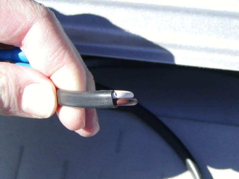

I drilled a 3/16” hole through the center of this body plug.
The wire went directly through that – I didn’t use the supplied grommet at all. This option is suggested in the updated instructions. The fit is so tight I think silicone sealant is overkill – but it couldn’t hurt.

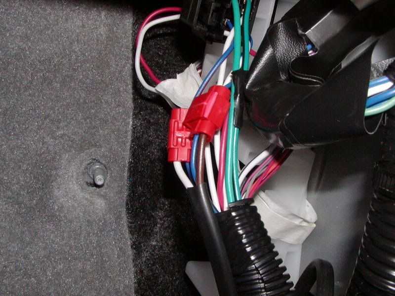

Once inside the cab (Access) run the wires to the channel under the door sill protector (already removed).

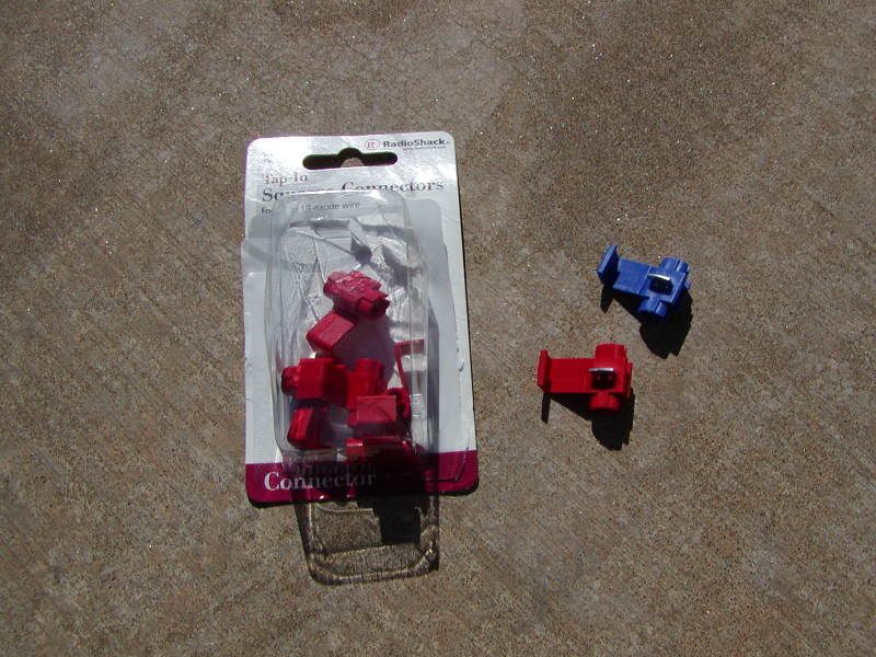

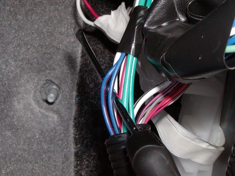

11) I don’t know why they send the blue tap splicers. Everyone uses red. I got mine at radio shack.
The correct wires are blue/black stripe & blue/pink stripe.
Not sure which does which. On my truck the Blue/Pink is connected to the white wire on the long harness, white wire on the short harness, and finally to the blue wire on the actuator. It works fine.
(Note: for a cleaner install run the new wire through the conduit below the connection BEFORE you make your connection)
