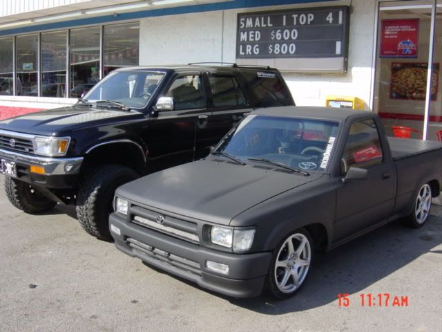

you can put 93-97 4 runner front end on with some modification i have 1 on my truck first you have to get the old grille and head lights out of the way and after that cut holes for clearence were the head light holes are you dont have to cut big holes but just enough for clearence of the composite head lights get some bolts because the existing hole will not work you have to drill a couple of holes take the bumper off for mounting. the whole thing took me about 4 hours but it was well worth it much newer looking and alot brighter headlights i will take some pics tomorrow so you can get a better look at it but you can see the grille below but it is kinda a crappy pic
