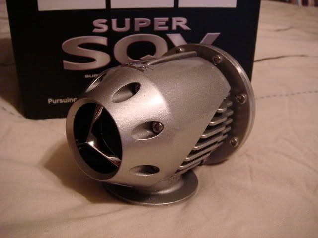

HKS Super SQV :clap:

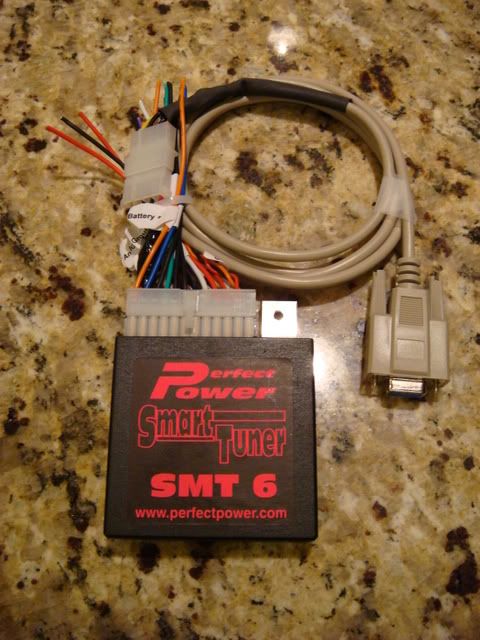

Perfect Power SMT-6

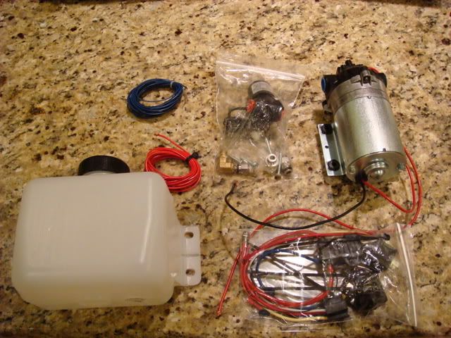

Water/Alcohol Injection Kit

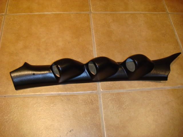

A-Pillar Triple Gauge Pod

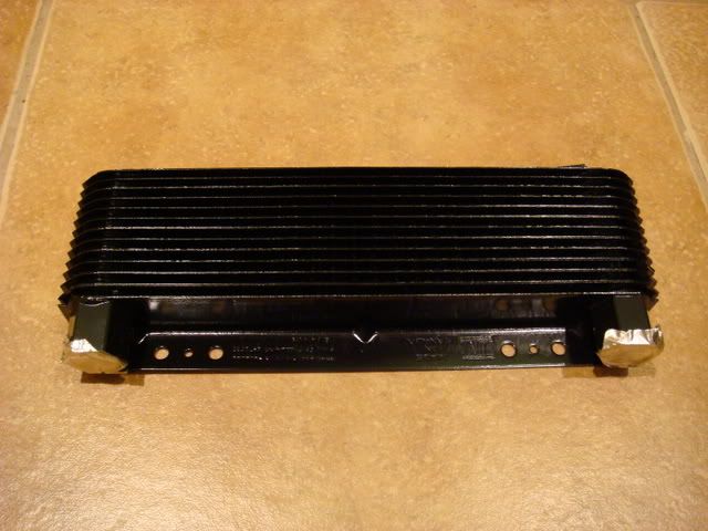

Oil Cooler

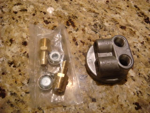

Oil Filter Relocation Kit

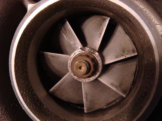

Compressor Wheel Close Up

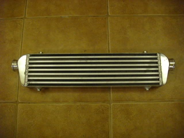

Intercooler

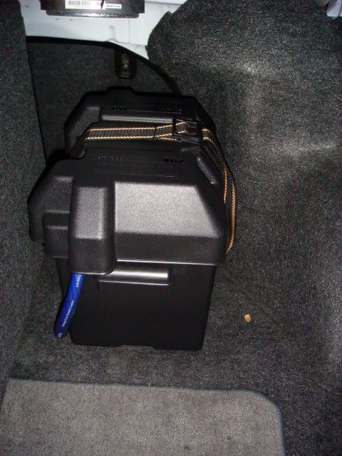

Relocated Battery

Wait an HY-35 I didn't see that around mr2 v6 forums I always hear about the hx-35 turbos. Is this one better for your power goals as in faster spool up times than the hx-35 turbos??
Indeed it is. They used the HY's on the automatic trucks so they'd spool up quicker on a light load. Updated with new pics. :clap:

Did they include the bung for mounting the nozzle for the water injection? Or do you have another method for adding it onto the pipe?
It's actually not included, although they do offer it seperately. Unfortunately I didn't know that until after my order was shipped. You can still screw it directly in though, no big deal.
#16 ·
If they didn't I'll just drill a hole & install it however works best. Tapping or flanging. If I have too I'll grab a bronze-nickle filler rod and tig it :lol: they'd be funny. I'd sorta like to see someone do that lmao!!!!
#17 ·
Tap and some JB weld should hold it right?
#20 ·
LOL... The only two things im doing that for is the water injection nozzle and the oil return line.
