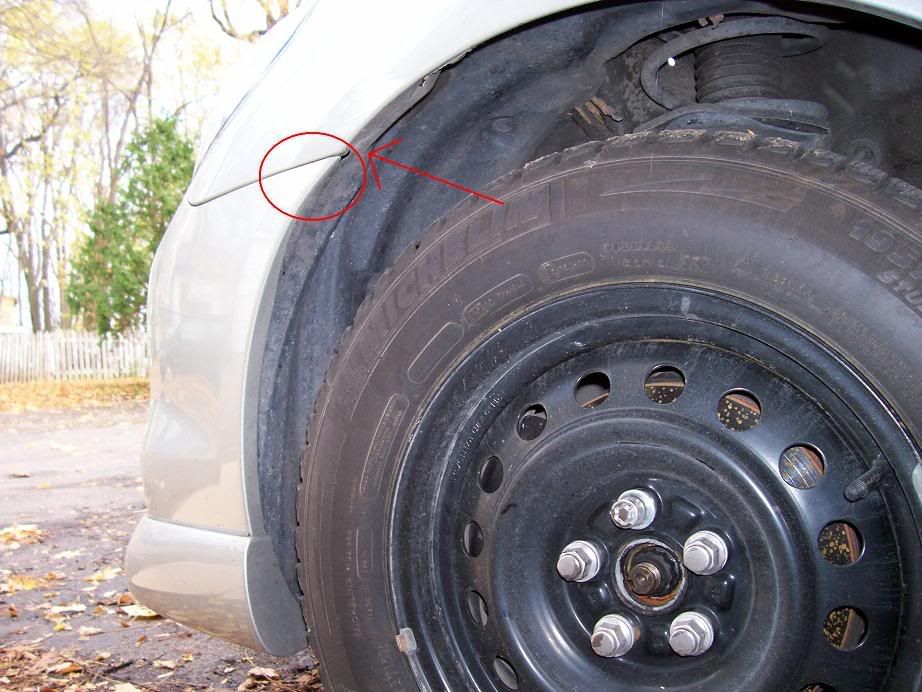

Whoa. Jacking and tire removal can be totally avoided. The 3rd hidden screw is accessible by simply removing the screws of the fender liner that attaches to the bumper. After loosening the liner, you can access the screw that joins the bumper to the body... (credits to thebarber for photos)
Once you've got the bumper loosened you can get to the hidden screw.
