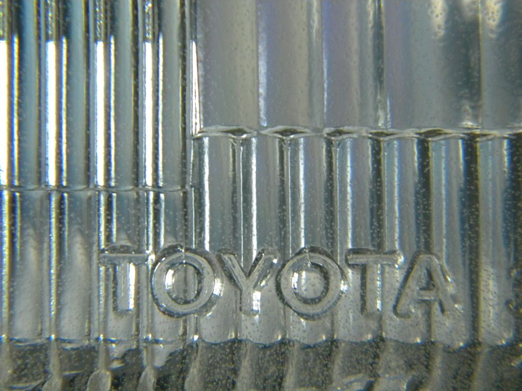

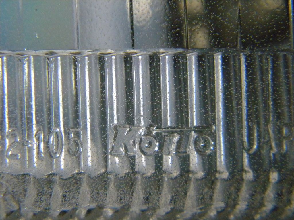

qqzj,
I went back at looked closer at the headlight assy, I posted the picture of and it has BOTH
TOYOTA and KOITO
molded into the lense.
and the housing on mine is definitely Black
( the "bubbles" on the lense is from when I sprayed the last coat of clear, I was at the end of my batch, I'm not worried for two reasons,
A, its now an extra. and B. I can sand them out, I put 5 coats of clear on it )>:D>:D

Thanks a lot! Which year is your Camry? Looks like a 4 Gen. Mine is 4.5 Gen and the lens look different.
qqzj,
TOYOTA and KOITO
