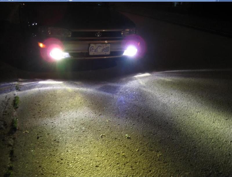

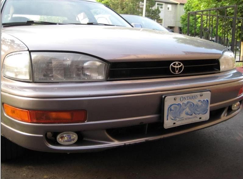

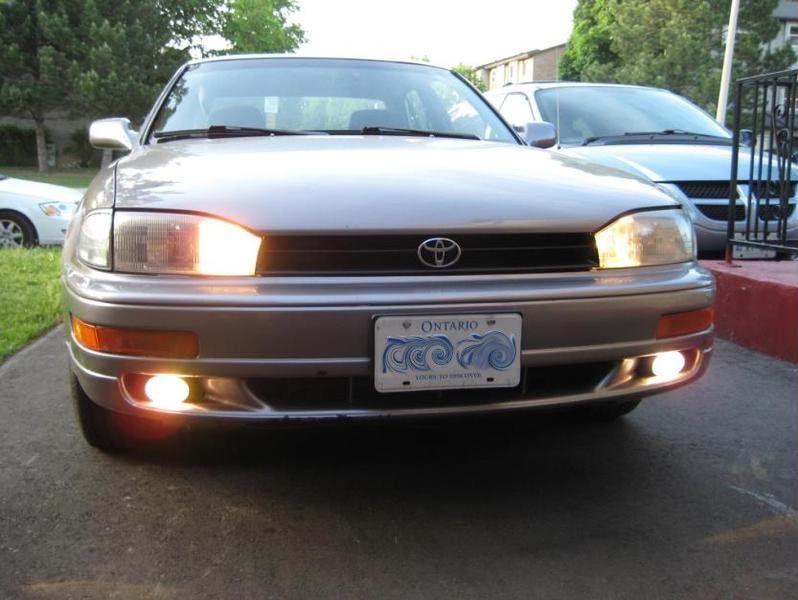

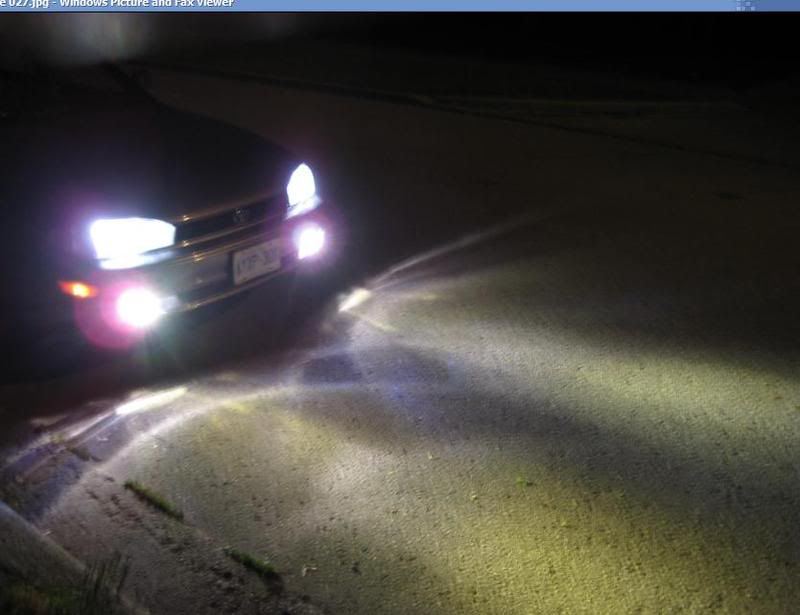

I just put em in. I think they look good. The 2500k bulbs have nice colour!
I have the 9005 mod in the low beams.

Looks great! and love where you've put them. Biggest thing is ones that aren't too big or they won't fit. Haven't seen alero ones around but will have to start looking.

I have an inline fuse and everything. When i said I wired them directly, I am splicing into the tail/parking light circuit. I disabled my DRLS so the lights will be on only when I want them to. Plus i like having them on all the time :D
I should wire in a switch but i failed at snaking the wire though the firewall.
As for the sizes: the tallest you can stick in there is 2.5 in. and you have about 4-6 inch width. The ones i got are 2.5 in by 3.5 in.
