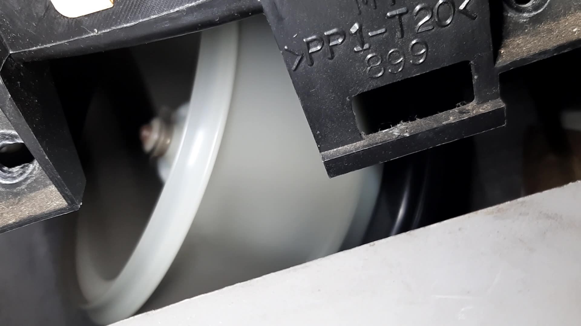

I removed the blower motor. It looks fine. The only debris were tiny bits of the filter in a few spots, but nothing to cause any issue. Here's a photo of that with the biggest pieces at 11/12 o'clock. The other pieces are tiny and on various fan blades. Nothing to cause any issue.
With the motor/fan removed I could see the vent opening which goes to the drivers side. I stuck my hand in there almost as far as my wrist and I didn't feel anything in there. Couldn't fit my hand in any more than that. I ran the motor and it runs fine. There's only about 1/8" of play, and it doesn't wobble. Here's a less than 10 second video showing the fan motor operating:
