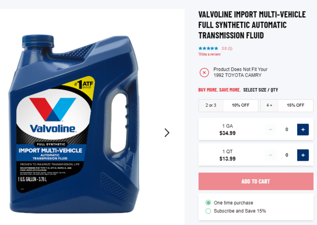

Also, what about this instead of the above 2 ATFs:
I.e. Valvoline Import Multi-Vehicle (ATF) Full Synthetic Automatic Transmission Fluid. Just $20.24/gal.

I think there are changes to the Valvoline ATF lineup. It looks like while Walmart still has the Dex/Merc, the Valvoline website NO LONGER lists that ATF. Instead there's only the Import Multi-Vehicle ATF. It's possible they changed the formulation, but I personally prefer to see it in writing on the back label.
That said, by enter the car info into Valvoline's website. It says the Import Multi-Vehicle ATF is NOT compatible with the 92 Camry. LOL!
Well, if the Valvoline tech support has updated info and they tell you that fluid is ok, then I guess either one will work. LOL
Valvoline site says "Product Does Not Fit Your 1992 TOYOTA CAMRY":

If you want to use the Valvoline Multi Vehicle Import ATF - sure, I'd use it. Don't pay $35 a jug, get it from Amazon.
Dex II/III and Mercon compatibility is listed, same as back in 2014 (first paragraph).
Current specification sheet attached, effective date of 5/9/2023.
#40 ·
Yeah, I saw that too. ;)
Not surprised, Walmart's vehicle selector does the same thing. "There were No results that fit your vehicle."
Given that we are talking about "Dex/Merc", a domestic-licensed manufacturer fluid ( GM / Ford ) that was "sunset" over 15 years ago, in favor of more modern ATF formulations: on a bottle marketed as an "Import Multi-Vehicle" fluid .. again, not surprised it's no longer on the bottle. aka: "Marketing". The Valvoline tech line rep. I spoke to back in 2014 basically said as much at that time: without outright saying it.
There should be a manufacturer fluid specification sheet, and safety data sheet - for any fluid: you are interested in using. You will find the full manufacturer specifications on that sheet.
SuperTech (Walmart) ATF spec sheet may be hard to find. It is produced / bottled regionally by multiple producers, including Warren, Exxon Mobil, etc. last time I checked.
Looks like it's compatible after all, per the doc date.
Btw would either or my drain & fill approaches above work?
