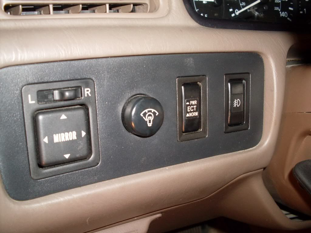

Step 4. Switch
http://toyotapartspeople.com/Search...archProduct.asp?Model=Camry&catid=319679311890993&year=00&productdesc=Foglights
If you don't have trac control or security order the dash switch
If you do have trac control and security order the console switch
Note: Unfortunately the console switch is discontinued.
Note B: You can either order the switch from them or from your local dealer. The part number is 00550-35976. If they say it has too many digits tell them its in the accessories catalog. Its about 20$ maybe less depending on the dealer
pic of switch:
I edited this again, didn't know if anybody was still interested in this anymore. Note: Since the switches are still used for newer tacoma ie early 2000s I think they will be around for a while, and snappy lights seems to have a lot of kits, so if anybody is interested in this I would get the brackets and bezels first so you have them incase they get discontinued that way all you need is the kit and the switch. If anybody needs anymore info of stuff like that please let me know. my # is 727-365-9530 (I have txting if thats easier just let me know who it is)
