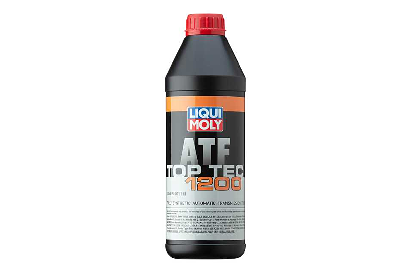

I was going to get 2l of Motul Dexron II D ATF fluid (which is red) due to it being a good price. I know that Motul products are good. Is the colour just a dye or has other significance? Other option (price) would be Liqui Moly 1145 3100 Steering Gear Oil which is also Dexron II D (I think this is green).
#11 ·
The 1145 looks like a mineral based oil of an obsolete GM spec (anything before Dexron VI). Many members here just use Valvoline Maxlife in the PS too, which is a Dexron VI spec and fully synthetic too.
You might consider Liqui-Moly 1200, which is a fully synthetic Dexron IIIh instead, but the 1145 should be fine too.
