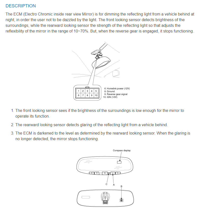

I've managed to install a GNTX 453 Mirror. What do you guys think? (I still gotta paint the wires black or electrical tape the bottom plug of the wires on the mirror so its less noticeable).
EDIT: Installed my mirror using the OEM factory plug instead of the cigarette lighter fuse. I've also hid all the wires as if it came OEM.
EDIT 2: Every harness on your GNTX 453 mirror might be different than mine that's why I didn't include color codes on my mirror. Most of the time though it's pretty obvious since you should have 3 wires. Most likely one of them will be black which is obviously ground. The rest of the two if you follow my instruction you can use those 2 wires for 12V only in ignition mode (only if you want to but i suggest this). If you don't want this then try either of the wires on the constant 12V or 12V ignition if you don't know where the colors go. It's not going to hurt your mirror its just going to make it more obvious where each wire goes. I hope this helps let me know if you still need help.
EDIT 3: THE GNTX 453 MIRROR ONLY REQUIRES 3 WIRES!!!!! HERE IS AN IMAGE OF WHAT EACH PIN DOES SO THAT WHETHER YOUR HARNESS HAS DIFFERENT COLORS OR NOT IT SHOULDN'T MATTER IF YOU FOLLOW THIS NEW PICTURE I UPLOADED!
EDIT 4: It turns out that some of these mirrors will come with a FOURTH wire. The fourth wire is PIN 9 on the mirror. Here is an image of what the fourth wire does if you manage to get a harness with four wires or you're just interested. https://i.gyazo.com/31c3712c3739890dee9dee27a5283430.png I personally don't see the fourth wire being that useful but if you want to install it then you do you!:grin:
Got any questions? Feel free to ask!

Hmm this is interesting. Try this again BUT this time make sure about 1 inch of insulation is remove. Wrap them both together very good! and then connect them to the only 12V ignition. I did this my first time and everything powered on like it was supposed to. I'm not sure why yours didn't power on. I've been using it since I uploaded the DIY video and its been working just fine. I think thought it had to of been not a good connection because sometimes that just happens. I hope you can give this a try again and see if it works. Also if you have discord we can talk on there if you want I can try to help you.
