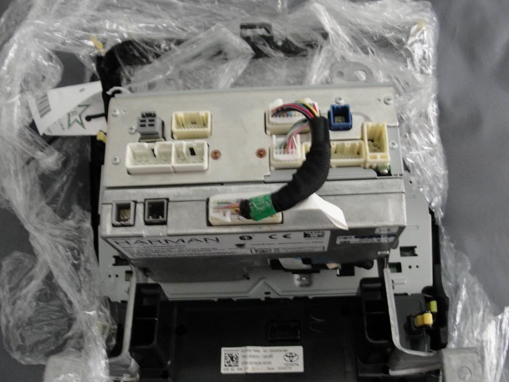

Update: Just received it this afternoon. It came with Harman Extension module.

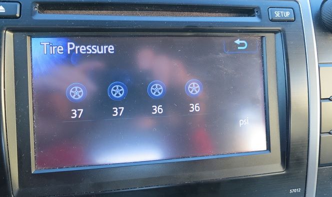

Surprisingly, TPMS feature is compatible with 2013 model. BTW, i have a 2013 Camry SE model and the navigation unit is 2012 Camry SE/XLE model. :nerd:

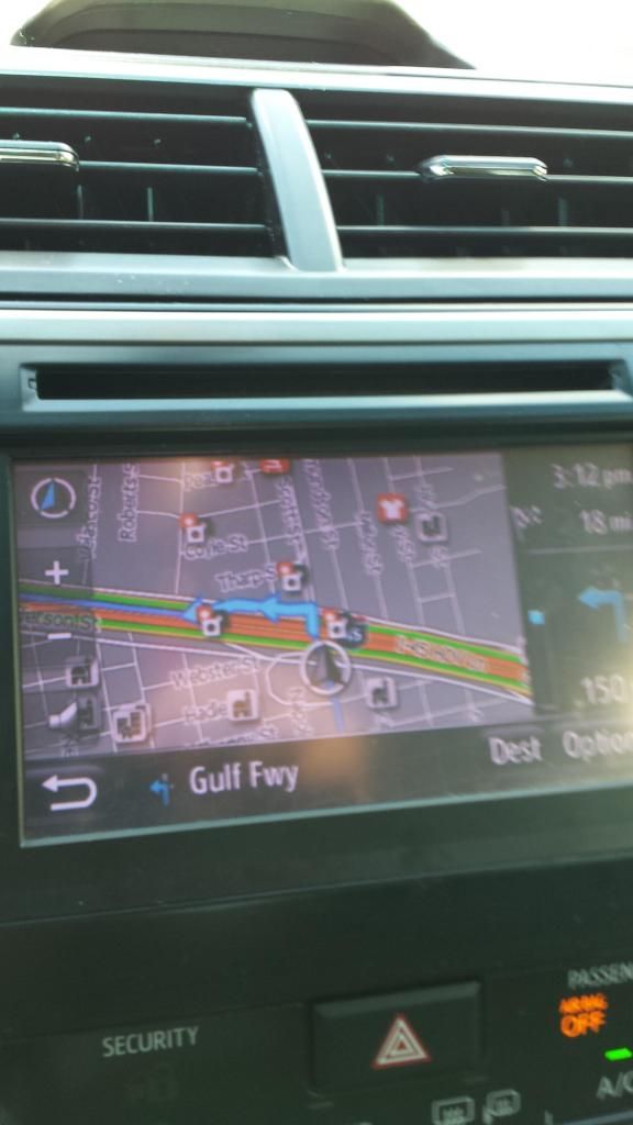

Done. I was able to use all features: apps, navigation,... except SAT radio. Total cost is $408.:grin:

2- Display Audio Entune or Premium HDD navigation? There are many different types of Entune HU. Some HUs come with extension module, and some don't.
3- Y harness? This harness will connect between HU and extension module. I always looked for HU with y harness, if it doesn't show on pictures, i will request the seller to obtain it from their car. You can also purchase it from Toyota website- part no. PT296-47120-AB.

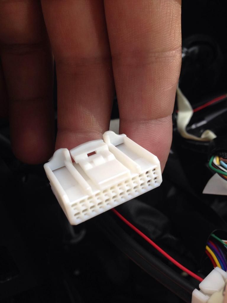

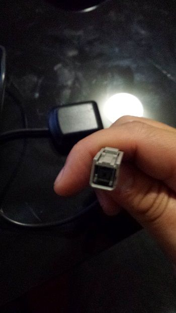

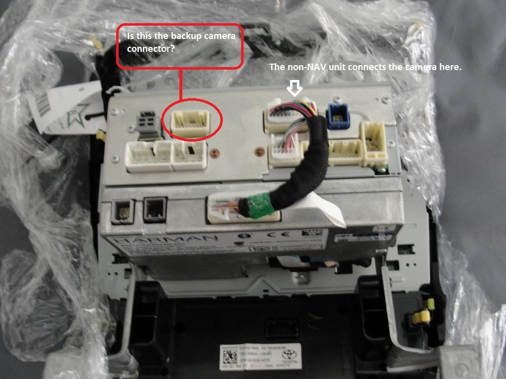

Okay, I was partially incorrect about having two plugs left over. I have one left over. My car has a plug that is identical in size and shape to the larger of the two plugs coming from the extension box. The plug has four wires on it. I left it disconnected since I figured the one coming from the extension box is important. Apparently I made the correct choice, because everything is working as expected! The only issue I have now is that the gps antenna does not fit the port in the radio as expected. It is very close, but it is not exact. Is there an antenna that fits it perfectly?
#41 · (Edited)
Thanks, that worked perfectly! It didn't want to snap in place once in there, so I just went around the connector with electrical tape to secure the connection at the extension box. Everything seems to be working now except for the backup camera. I have a feeling that the connector I had to leave off is the one that has the camera connections on it.

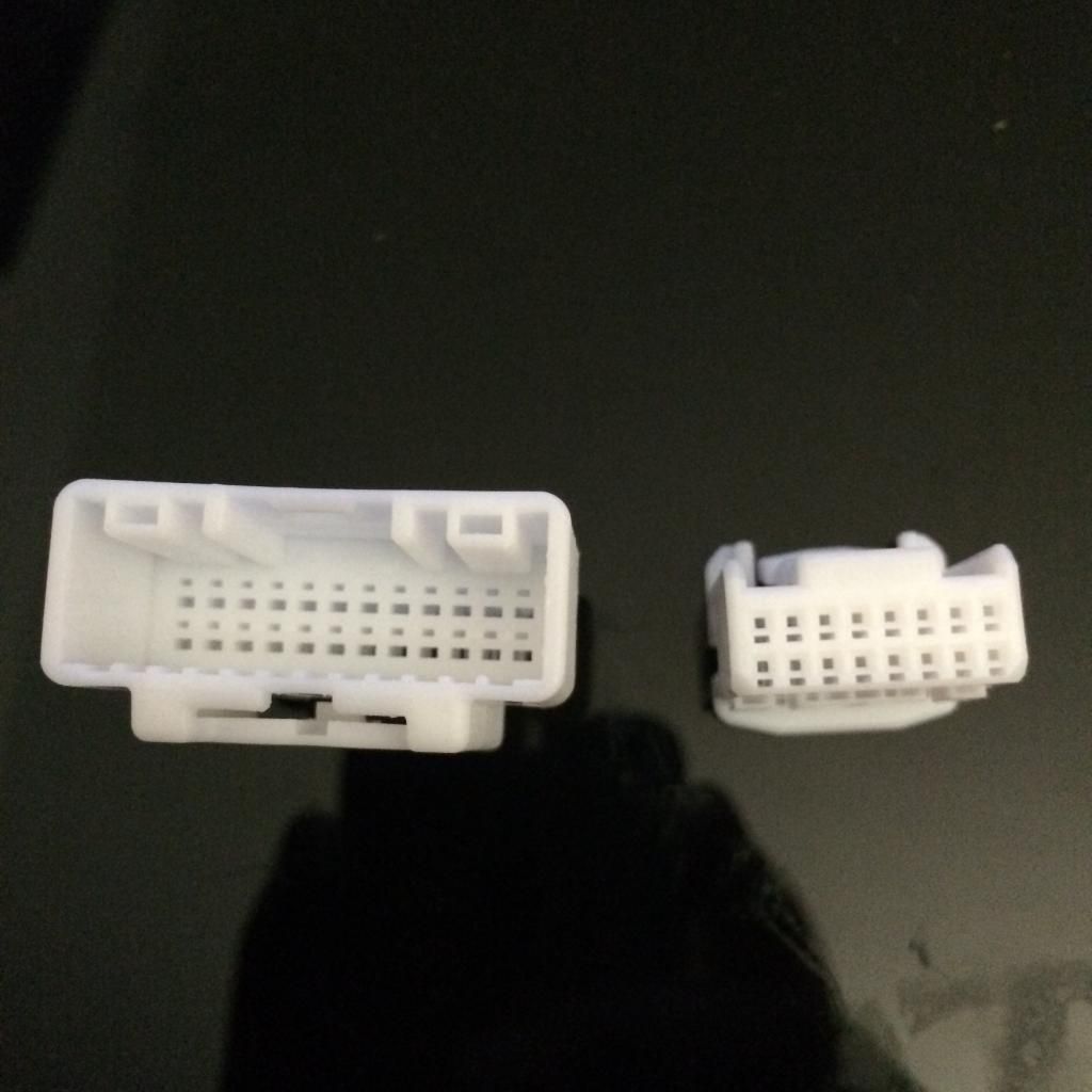

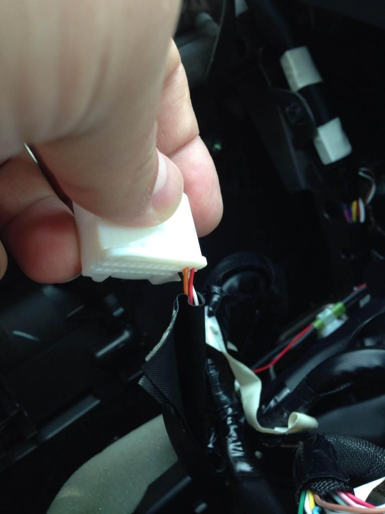

Here are pics of the connector. It is identical to the larger of two connectors on the y-harness coming from the extension box, so I don't know how I can get these wires connected to the radio. I have to choose one or the other.
#42 · (Edited)
Another pic that might help. I think perhaps the NAV and non-NAV units use different connectors for the backup camera.
UPDATE: I found this site that confirms the remaining port on the back of my radio is the camera port. So it appears that the non-NAV, non-Entune units use the 24-pin connector for the camera while the NAV/Entune units use a 16-pin connector. I need to find a harness that adapts my connector to 16-pin or make one myself in order to get my camera back up and running.
This website may prove useful to others who encounter this problem in the future: http://ae64.com/Rear-camera-16p-operation.htm

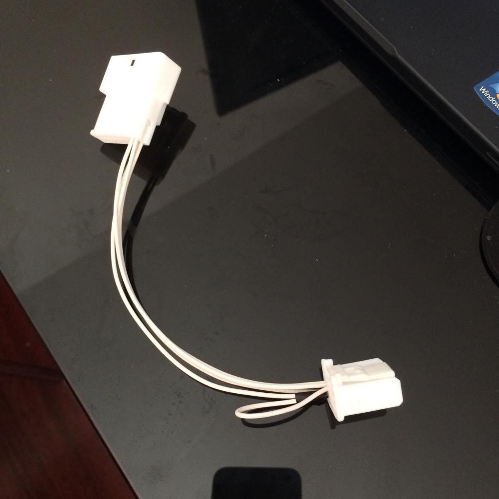

That is not truth. I installed it on 2013 SE and it used 16 pins connector for backup camera. I think they changed on 2014 models. I can custom one these connector for you from 16p - 24p. It will cost you about $30 + shipping. My store on ebay: http://www.ebay.com/usr/ip4d
