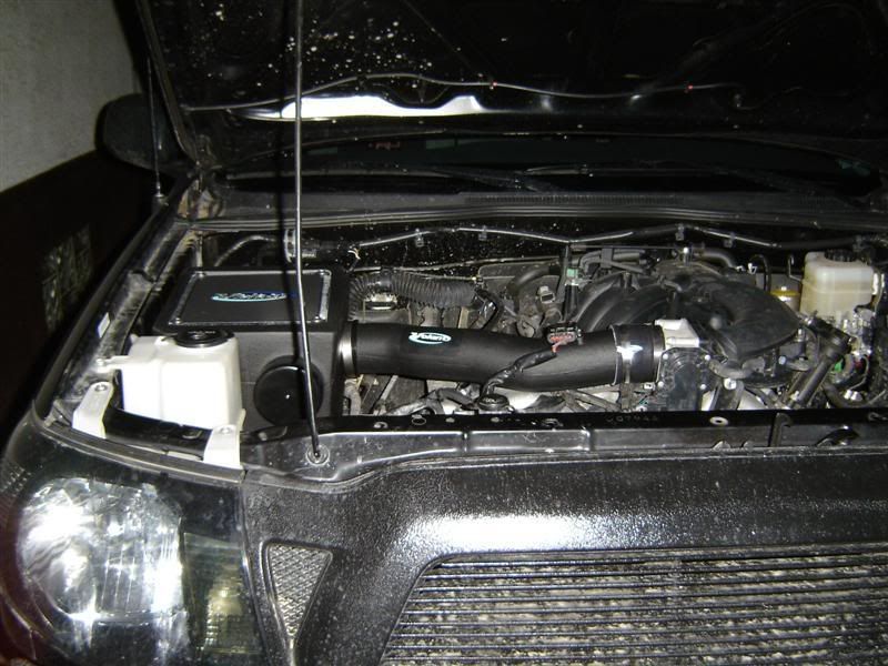

:thumbdown I'll start of by saying don't buy it. Here's why, I have the LC-1/XD-16 combo(a wideband O2 controller and gauge) and the URD maf calibrator so I can see what's going on and tune for best performance. I can also immidietly see the difference of any mods I do via the wideband gauge. The volant dropped my AFR's by over one point across all RPM's. On a stock vehicle that would mean running 9:1 at WOT! Stoich is 14.7:1 (best fuel economy), and best power is achieved around 12.5:1 just to give you noobs an idea of how far off it is.

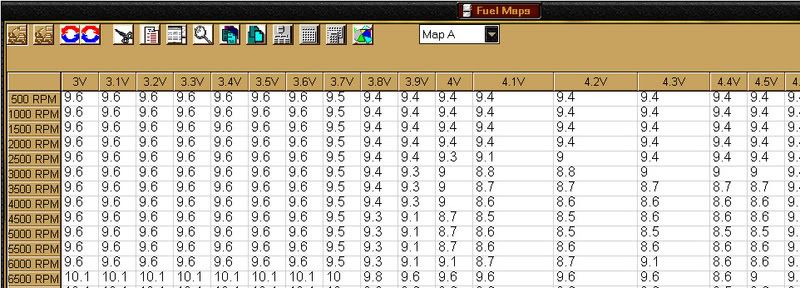

Well after about a half a tank of gas I think I'm finally tuned. That Volant pos is a pita to tune. I had to pull out a lot of fuel. At WOT above 3000 rpms it hangs right at 4.2V and to get into the 12's AFR wise I had to write 8.5 into the "sweet spot" column which for me is the 4.2V column. That seems like a hell of a lot, no? I started with Urd's baseline map that came preloaded, selected all, then took out -5%, and that only put me into the low 11's. Don't buy a volant if you don't have a MAF calibrator! Better yet don't buy one period. It is a lot louder, and maybe a little faster, but this is what my wife said after going for a ride "Why don't you quit wasting your money on this kindergarden shit and save up and get a supercharger". I love that woman.

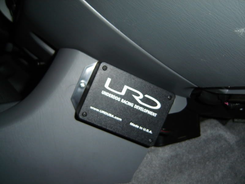

It's not hard at all, 5 just because of the pucker factor if you screw up. I learned how to tune using gadgets u tune guide http://www.gadgetonline.com/U-Tune.pdf
and by lurking in the performance sections of TTORA and Custom tacos. When using the MAF calibrator software to change the A/F ratio a 10 is stock (no change in signal), a lower number makes it leaner (less fuel), more than ten makes it more rich, opposite of the A/f ratio (lower number more rich, higher number more lean) . After tuning fuel trims to zero, you can record the runs on the laptop, so just hit record and go bang through the gears watching the wideband gauge. You are shooting for a 12.5 on the gauge at full throttle from about 3000 rpm's to the rev limiter when the truck is in open loop. So if it's say 11 at WOT (wide open throttle) you know there is too much fuel, so you go back to the R4 program and select the cells that are highlighted during WOT and lower them by .1, go make another run, and then do it all over again. It's time consuming that way, but totally safe. Also you can look at the recording you made, and click on it anywhere to see what the numbers were and what cells need adjusting.
You can see from the recording I am at 5004 rpm's where the little dot is, and it is in the 4.1V cell that has an 8.9 written into it. I was at 11.2 AFR, so I lowered the number a little and went on another run. This was a third gear pull, can you tell where I shifted from the graph?
