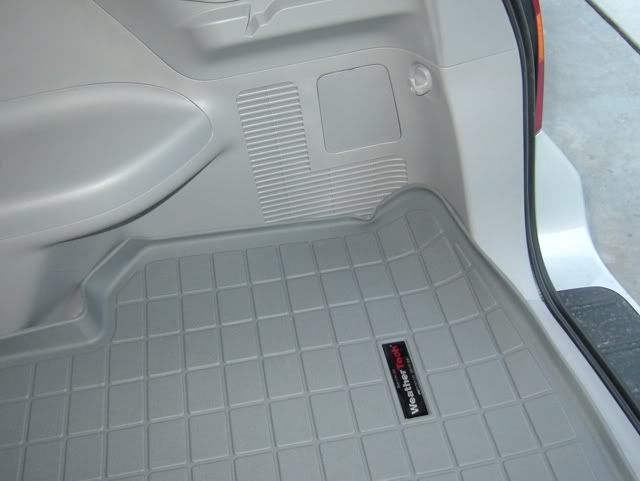

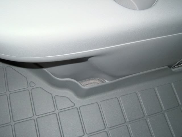

Here are the cargo liner pics.
By the way, I just received the front and second row floor liners. The front driver's side has the same issue previously identified here. Bummer!!!
#25 ·
What difference does that make? Will removing the factory carpeted cargo liner first cause the Weathertech liner to magically follow the contour of the cargo area? Take a good look at the pictures. I just threw it up there to do a quick check. Why the heck should I bother to remove the factory carpet cover if the weathertech liner does not fit?
#27 ·
Nohodas: The reason your cargo liner fits like it does is because it is made to accomodate the seat belts of the folded down 3rd row seat (for vehicles that have that installed). There is no getting around that. I do think, however, that if you slid your back seats forward a bit the liner would fit a bit beter towards the sides where it is buckled in the photos. My OEM Toyota liner (black) fit as yours does when I first installed it, but I managed to get it smooth.
#29 ·
ktmd, I did what you suggested and it does fit better, thank you. Overall still not happy with the product. The front passenger side and second row fit perfectly, just as advertised. The front, driver's side is about an inch too narrow towards the seat side and the cargo liner has its own issues. These things are going back Monday morning. I am sure MacNeil will enventually work the kinks out and will have a solid product in the end.

Ok, so I just received a replacement Tan drivers side floorliner for my 2008 Highlander. It seems to be the exact same problem with the fit. I will try to get a photo of it soon. The gap by the door sill is still a couple of inches off. I am impressed by the customer service so far, and I hope this issue will be brought to a resolution soon. Has anyone else received a tan replacement that fits tight?
