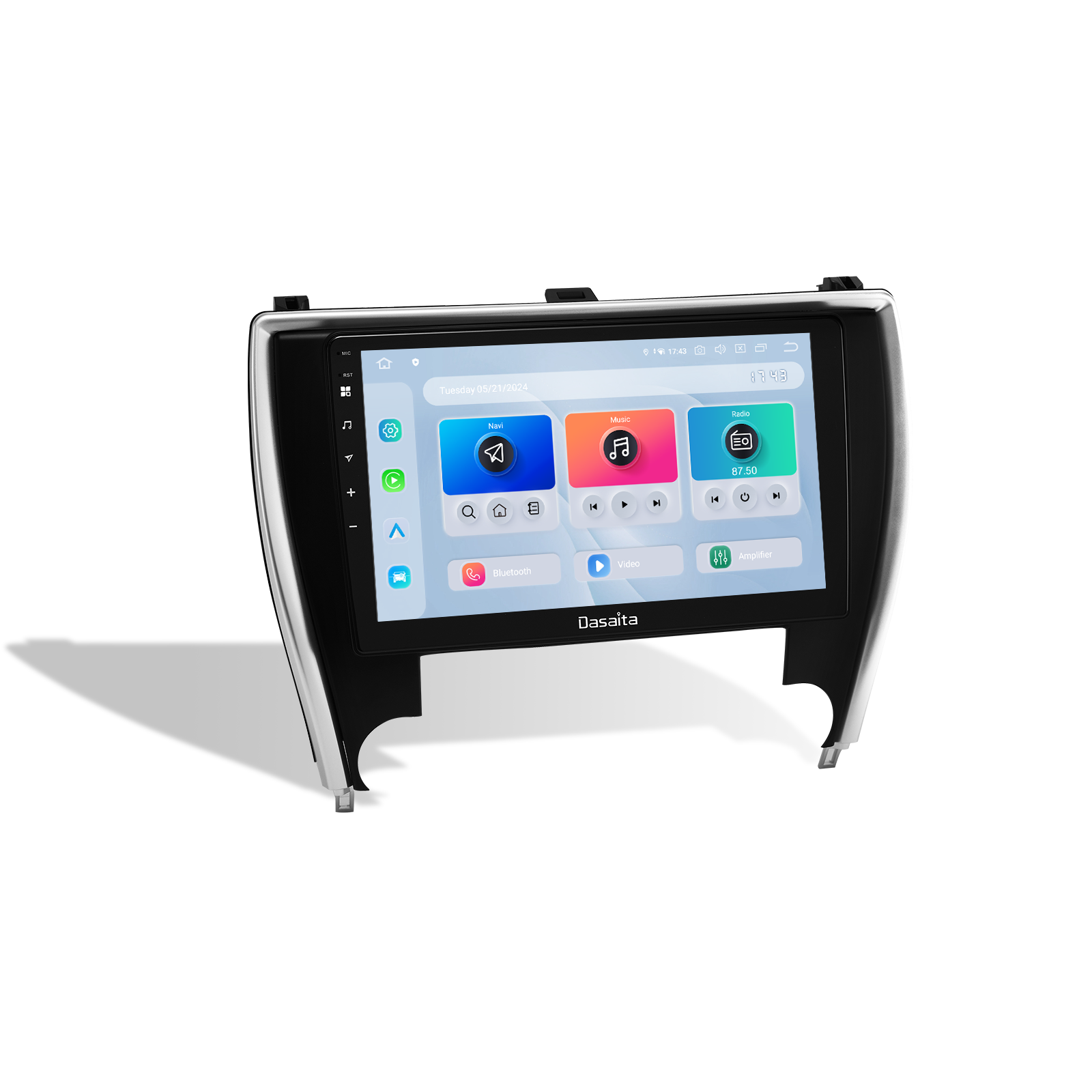

I want to upgrade from a 2015 NAV head unit to something that supports CarPlay. I see about fifteen different head units ranging in price from $90 to $550. Dasaita website alone has 4 different models. On paper they all seem to be the same - at least as far as features and screen size.
Should I go for the most expensive one ( Android 12, Dasaita Android12 Car Stereo for Toyota Camry 2015 2016 2017 Wireless Carplay & Android Auto Car Radio | Qualcomm 665 | 10.2" QLED Screen | Wifi+4G LTE | 4G+64G | DSP|GPS Navigation Head Unit | Optical Output )?

Ok, bit the bullet and went with the most expensive option:
I was in "luck" as just prior to doing the install the stock head unit crapped out and is now stuck in the infinite reboot loop. So I will be not just upgrading the head unit but also fixing it! Here it is installed in my 2015 Camry XSE V6:
Here my impressions:
1. Install is 100% plug-n-play but yet creates an ugly entanglement of wires inside the dash (not a big deal as you cannot see it).
2. The screen is glossy and impossible to read in daylight with open sunroof.
3. The screen does not have dynamic brightness adjustment with ambient light (like every modern cellphone) - although the color scheme does change when the headlights turn on. It is ok but I still find the screen to bright in the darkness and too dim in the daylight. There is brightness adjustment slider but it is a joke. It requires many clicks to access and only changes brightness about ~20% min-to-max.
4. Overall system is very fast and responsive - no complaints.
5. Call quality with the built-in microphone seems to be good.
6. Navigation prompts and playing media info in the instrument cluster do not work anymore.
7. Volume is TOO loud! At about 50% setting it is already overloading the speakers. The lowest volume setting of 1 is already too loud in some situations (like parked in a quiet garage with the engine off).
8. All the steering wheel buttons work. Pressing a voice command button starts Siri or Google assistant.
9. Both wired and wireless Android Auto works. The wired interface charges a phone very slowly (~5 hours to full charge) - therefore I prefer to use wireless interface while getting power from a fast 12V car charger.
10. Aux In does not work anymore.
11. There is no Android Auto YouTube app! The last couple of years I mostly listen to Youtube when driving (audio only). It worked fine with the stock headunit but I am still to find a way to make it work with this one.
12. Built-in AM/FM radio is not very good. Reception seems to be on a weaker side, there is no support for HD-Radio and the interface is buggy. Fortunately I do not plan on using it often and there are much better apps for listening for all possible radio stations over internet anyway.
13. I am still missing the volume knob as my hand constantly searches for it to adjust volume. Gradually learning to use the steering wheel controls for this purpose.
