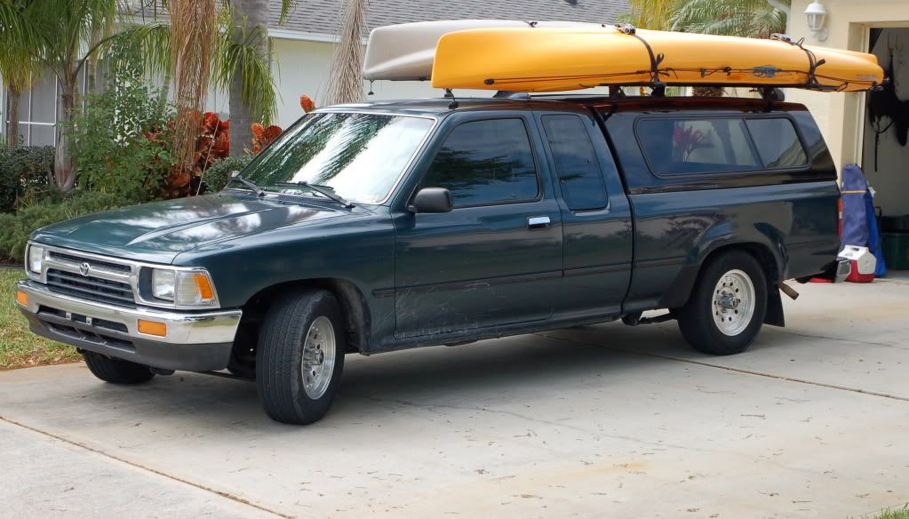

Since I put a topper on my truck I've noticed that it rides lower than it used to- the topper weighs about 200lbs so I expected some compression. Is this how low its supposed to ride or are my springs sagging? The initial drop from the topper is the most noticeable. After loading it down with 2 kayaks, dive gear, luggage etc, it only dropped a tiny bit more.
If I were to raise it up a bit, what would be the best route? Air shocks, helper springs or add a leafs?

Ah but your truck looks so much better than mine!
How does it ride with those shocks?
I actually thought that your truck was very sharp looking! I don't think mine looks better.

Thanks- that picture makes it look better than it is. The clear on the roof is almost gone and the hood repaint I did last year doesn't match the rest. I plan on getting it and the topper painted soon. I just have to decide between doing it myself (rent a booth on base) or having maaco do it after I prep it.
