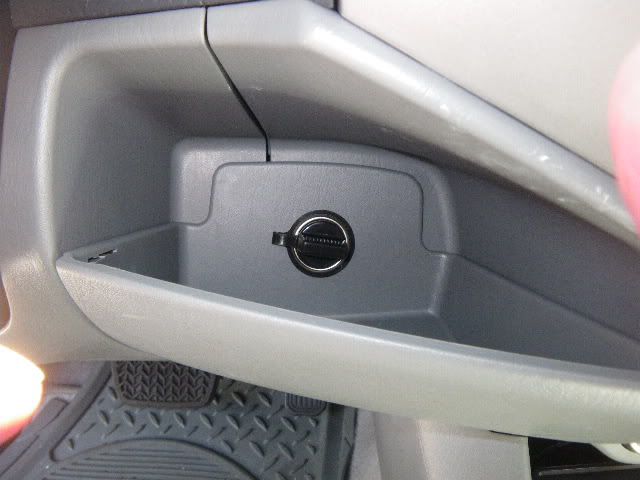

I installed the 12V outlet inside of the aux. tray on the right side of the steering column. There is plenty of room for your hand to plug in your GPS or cell phone charger. The tray removes easily from the back side. There are 4 colored clips on the back side of the aux tray. They are easily squeezed together with a pair of needle nose pliers. While squeezing in on each clip, gently pull the tray outwards and the entire try will pull out after the 4 clips are released.

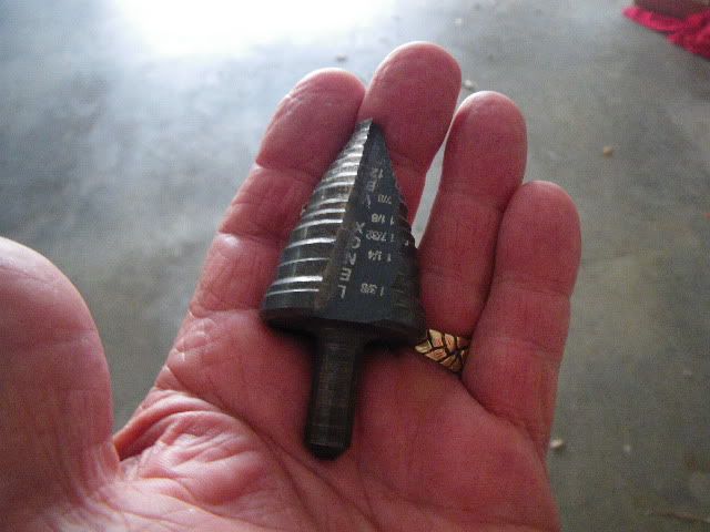

I used a step drill bit to drill the hole, I would guess the hole to be about 1 inch, but measure first before drilling.

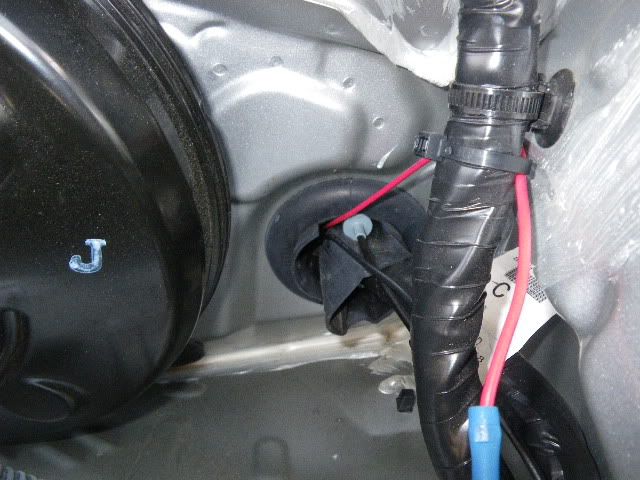

I used a small sharp end punch to push a small hole through the wiring loom boot on the left side of the steering column and pulled the hot and ground wires through. The boot is soft enough rubber that it seemed to seal tight around the new wires.

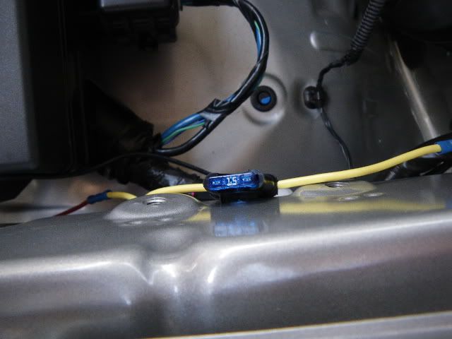

The inline fuse was attached to the inside fender with a piece of 3M double sided tape.

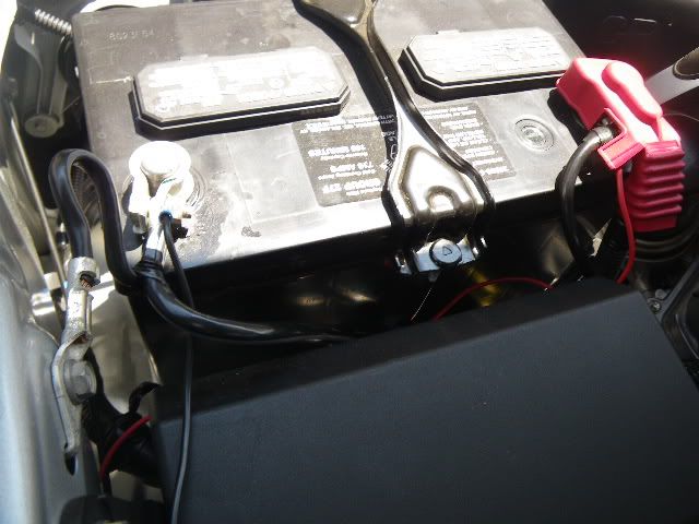

Using two ring terminal ends, I attached the wires directly to the battery cable bolts and the job was complete.
