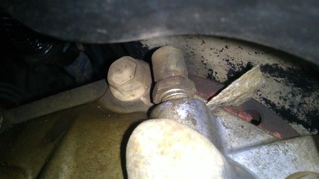

I got around to doing this on my truck. I followed the same recipe, except that I also did the front diff. This one is a little tricky, because there is only about 3/4" of space between the breather and the bottom of the oil pan. I shortened the breather hose connector to about 1/2" long and made it bend about 30 degrees. I did this by slicing out the middle section of tubing and TIG welding the two ends back together. Now it _just barely_ fits up there without kinking the hose.
I think the "right" way to do this would be to find a male-to-female 90 degree connector, so that you could screw it into the diff and then attach the hose barb from the side. Unfortunately, the thread isn't NPT. It looks to be BSP (like the oil sender) but I didn't check it with a thread gauge.
Here are some pics:
Anyone know of a source for BSP fittings?
