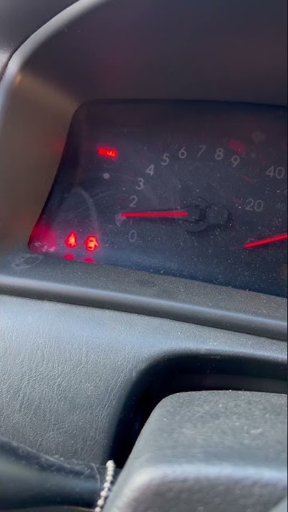

Hello, as stated I have a 2005 XRS and today I was sitting at idle and the car died.
attempted to restart and it just cranks. There’s no CEL and OBD won’t communicate with it. Swapped ECU (didn’t learn the immobilizer yet but videos show the light should still come on)
checked what relays I could (above glove box,engine bay, kick panel) and tried swapping them with an 07 S’ and they didn’t make any change.
Is there anything specific I should check? Anything I missed?
It will occasionally come back on and will click on and off with something behind the cluster but can’t figure it out.
Please help
I’m thinking vacuum leak, but it mimics what I experienced in the past.

Okay, everyone. It happened again car worked fine for a few weeks. Drove it last night and it was fine. Today it did it again.
This isn’t a vacuum leak, it’s not bad gas.
THE COMPUTER IS NOT COMMUNICATING WITH THE CAR. happens out of the blue for no reason.
This isn’t something that’s just as easy as air spark fuel. Etc. scanners won’t talk to the ecu nor will it talk to the car.
not a bad ecu, swapped another and relearned the immobilizer, same issue. Please suggest some constructive things here other than things that would prevent a functional vehicle from starting. I have an electrical paperweight.
Relays and fuses all appear fine and they all work in an 07 S, they’re not the issue.
