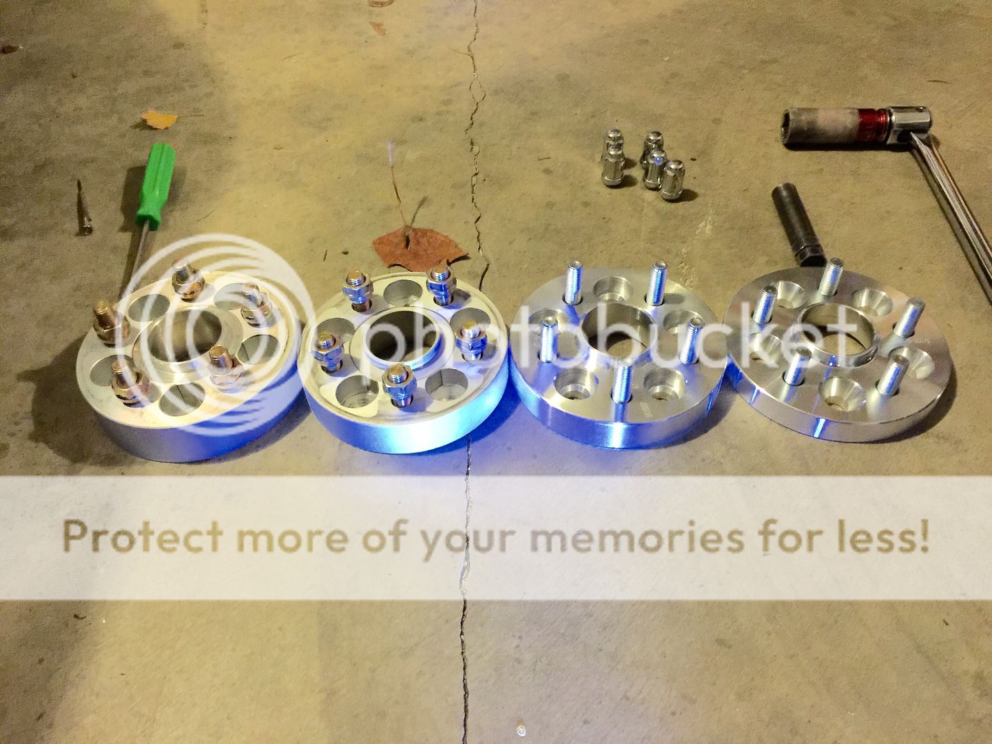

If you use a 5mm spacer you will need extended studs but it will look terrible with the wheels so sucked in. Use a spacer that has new studs on it so you can just bolt them on. I use 20mm most of the time and they fit and look great. The smallest I would use are 15mm. Just use ones built from billet aluminum and that are hubcentric with a 54.1mm bore.
Here are some pics of some of my various sizes.
#17 ·
1 inch spacers wouldnt be too much for a 48 offset.. mine do not pop out with 25mm spacers and i have a 40 offset vs stock 33. also, my 114x5 spacer adapters are absolutely not hub centric and have not had any problem this summer with them. Doesnt mean I wont run into an issue later on...
#19 · (Edited)
couldnt find them at a reasonnable price. the one i got have no lip to adapt to the 73mm wheels hubs and also arent centric to the car's 54mm hub. finding 54 to 73,1 spacers (and 5x100 to 5x114 adapters) would reduce my choice to basically only one supplier and i think it would be about 100$ per spacer before shipping when mine cost only a fraction of this (under 150 for all 4 shipped)...
I figured i would stop if its falling down and I retorqued the bolts on them after 500miles. all seems right, no wobbling (for now)
#21 ·
They are all over eBay for $150 or less shipped for a set of 4. These come in all sizes for all cars. I had no problems finding a high quality set of hub centric spacers made from billet aluminum.
