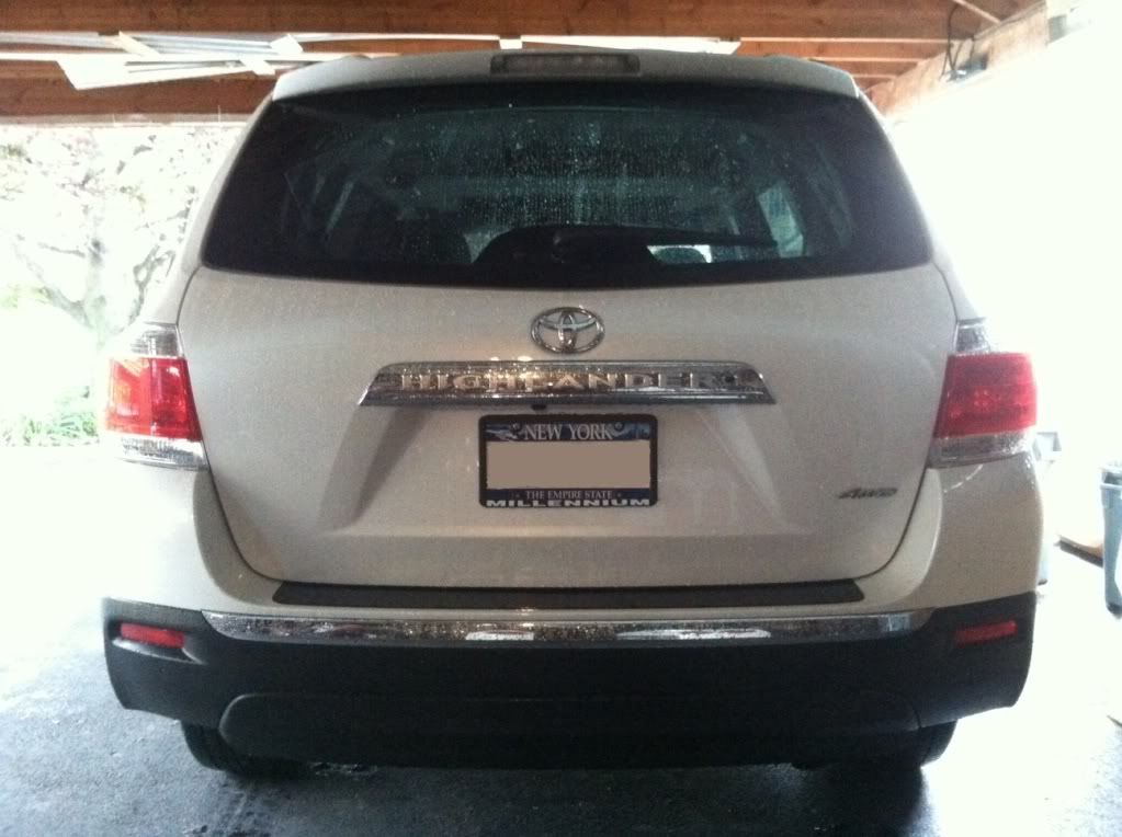

Well I finally decided to spend the $$$ and buy the hitch and harness for my ride. I used the install pdf's that I found here on the forum and it took about an hour and a half to do the job. It was fairly easy and straight forward, especially with the help of the directions. Definitely looks better than aftermarket IMO. Here's some before and after shots.
