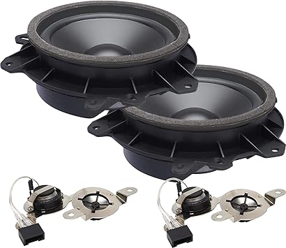

Powerbass OE65C-TY - $129
Same as with the rears, these are a perfect fit. Much bigger magnet, much higher quality build. Only difference is it's a component kit with separate 6.5" woofers for the doors and replacement tweeters for the dash. You'll need to use the included adapters for the door speakers and correct connector for the dash tweeters.
Once again I Tesa tape wrapped the adapter harness and secured to the other door wiring.
Amazon.com: PowerBass OE65C-TY - 6.5" Toyota OEM Component Speaker Upgrade Kit - Pair : Electronics
www.amazon.com
