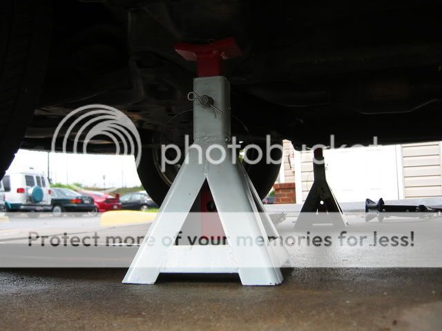

2. Raise the car and secure it on jackstands.

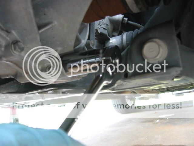

3. Open the hood and find the fill plug (indicated on the picture).
4. Use a 24 mm socket to remove the fill plug.

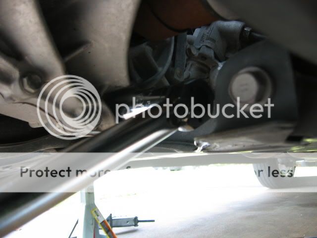

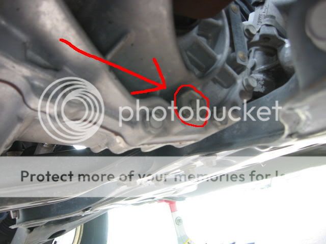

5. Find the drain plug from the underside of the car.

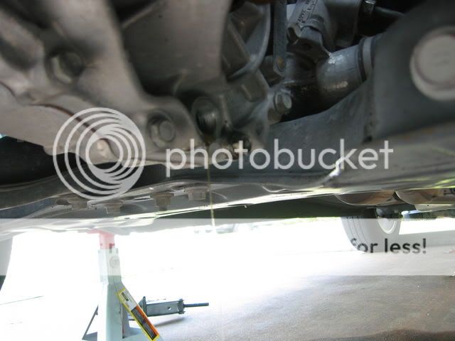

6. Use a 24 mm socket to remove the drain plug.

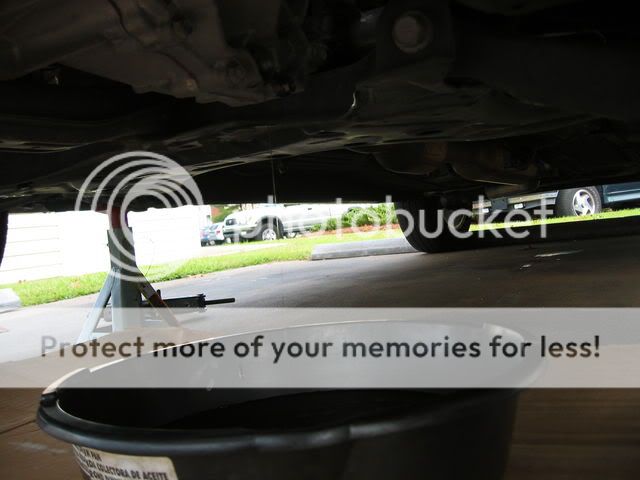

7. Let the old oil drain.
8. Into the oil pan, of course.

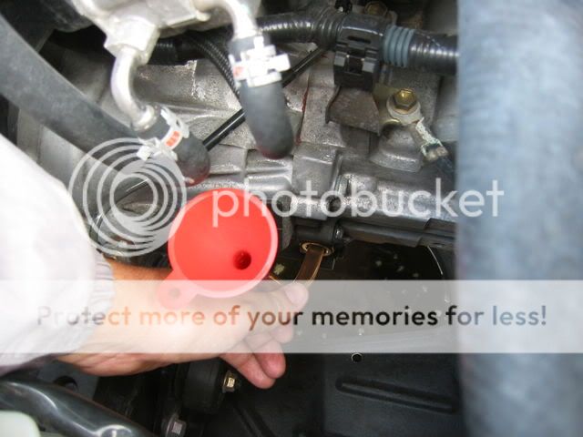

10. The easiest way to fill the transmission is using a tube and a funnel, as shown. I should have bought a longer tube, so I wouldn't have gotten cramps in my back. Fill it until the oil starts to run out of the fill hole. It should take exactly two quarts.

That's right, but you can just pour in exactly two quarts, because that is how much it takes. After I finished my second quart, the fluid started to slowly drip. The car wasn't raised much, so it was pretty much horizontal. I added the info to the DIY.
