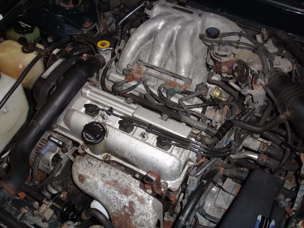

Posted pics of the valve cover cam plug thing before I forget to. Again.... is it essential for a new one? Not sure, maybe some just use again and seal it up good. It is a common place for the valve cover leaks though.
I’d say it depends on its condition. If the plastic is stiff (brittle), or the rubberized circumference is boogered up, replace it. I reused it on the front head of my 3VZ V6 (same head, front/rear?) with a thin film of sealant. It didn’t leak.

You can find a variety of DIYs members posted over the years:
Although some now are missing pictures, such as this valve cover gasket DIY, but the texts are still there. There are a couple of pictures here and there in the thread.
But similar (3VZ):
A few words on the half moons, and valve clearances can be checked as well:
And the comments on the valve cover bolts and extra washers:
