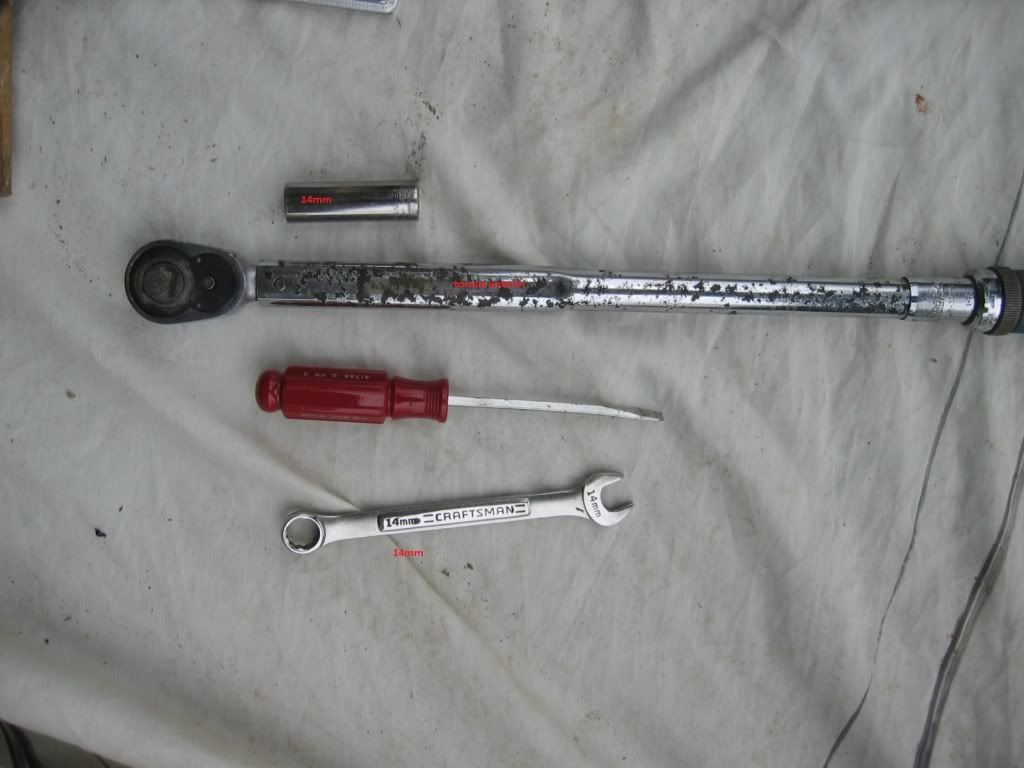

Use the appropriate tools and follow instructions as indicated.

Using 14mm socket remove nut from wiper. Take care when removing wipers from gear bolt. Gently rock it back and forth until loosen, and then pull up slowly. You might want to use a protective cover on hood to avoid scratches.

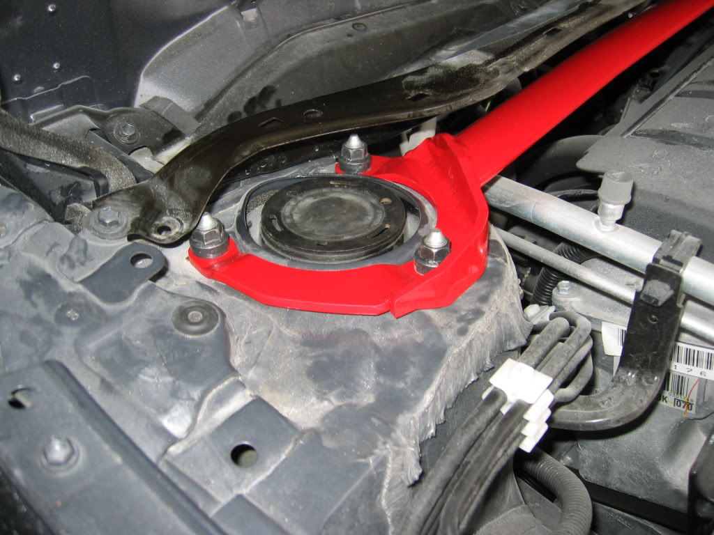

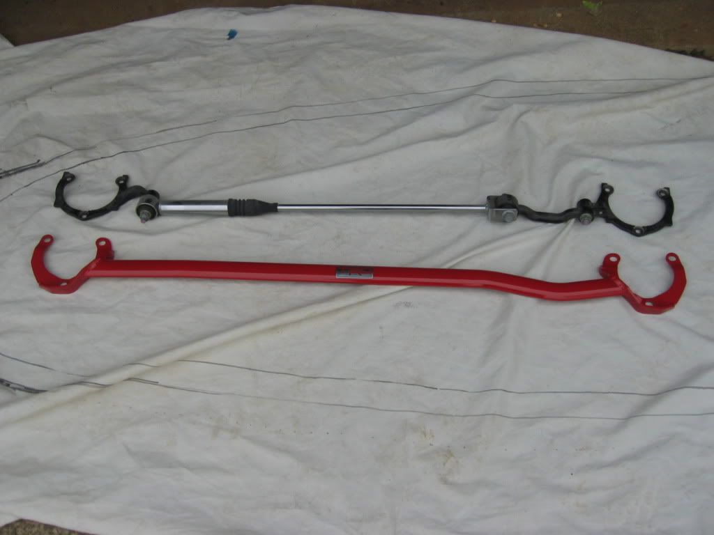

Remove the 3 nuts with a 14 mm wrench on each side of the strut towers. Remove old strut bar (for XRS) and place new strut bar. Torque as indicated.
It should look like this.
