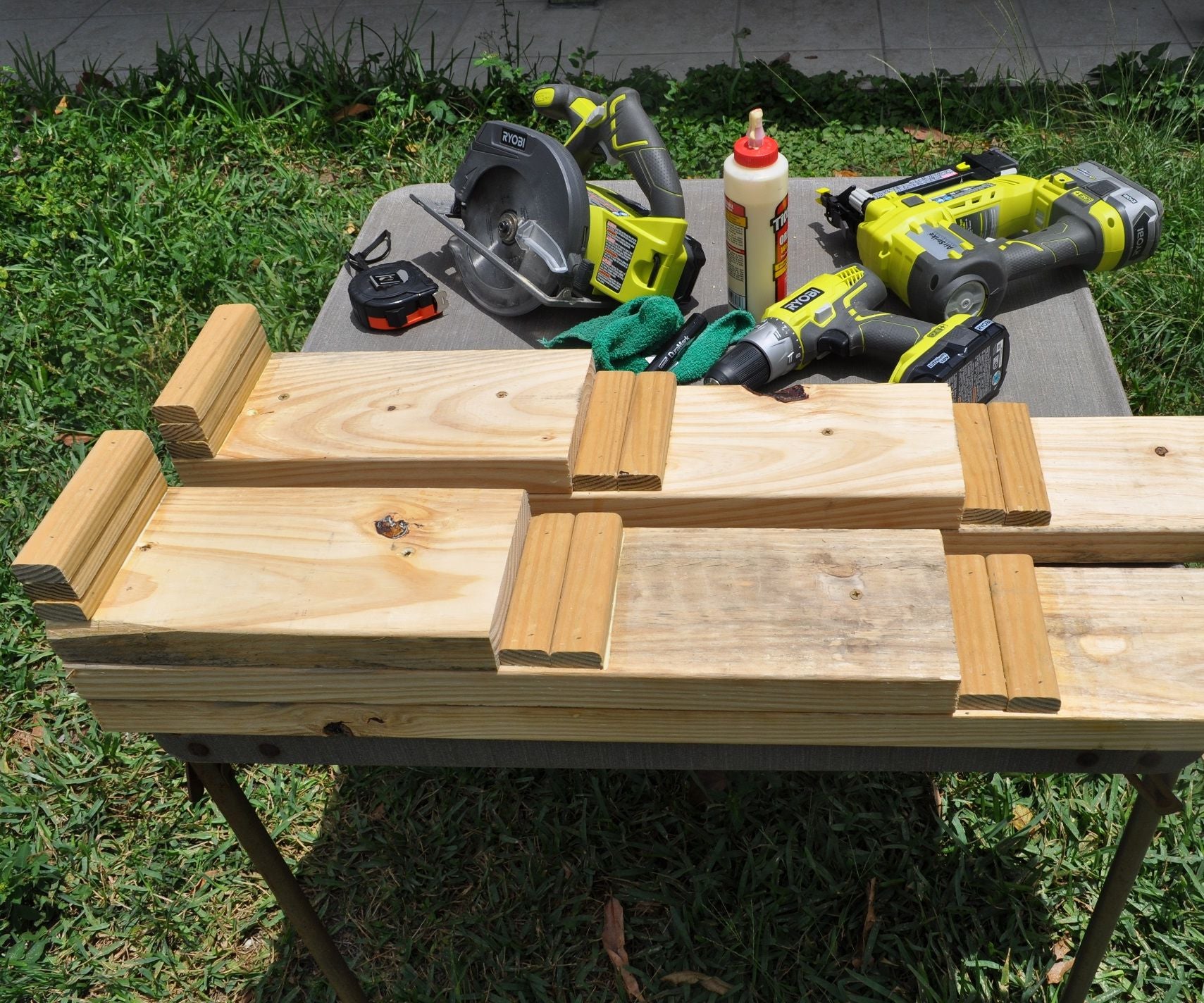

You can also look at Harbor Freight for tools and floor jack (either the store brand Pittsburgh that I use or their premium Daytona line). Sign up for their email coupons. I do like the lift height of 3-ton ones. 1.5/2 tons usually lift to only about 13-14", so with 3-ton's 18-20" there's more flexibility in what you can use it for. Or make your own lumber ramp,, it's faster driving on and off.

I use ramps for oil changes. Very easy to do. I had the rhino until one collapsed, so I made some wooden ones like the ones someone posted; heavy but very safe. For tire rotations, I lift one side and swap the front of the wheel and back. Use jack stand anytime you will be under the car, also chuck your ground wheels, and use your emergency brake.
