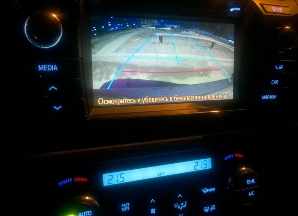

Hello, I just received my new 2015 Corolla S Plus. I really like the car, but when using the back up cam at night it is very poor. I had a 2011 Avalon and also a 2013 Prius and their cams work fine at night. I first checked to see if the lens was dirty but after cleaning it multiple times it is very clean. I saw in the search option someone with a 2014 Corolla installed bright LED license plate and back up lights to fix this. I would think Toyota would have updated this if it is a known issue from 2014? I think it's all kinds of wrong to have to go tearing apart your inner trunk liner yourself to upgrade bulbs from a parts store to make your factory cam work properly. Does anyone have a clear cam at night? Mine is substandard at best.

Sounds like I have about the brightest bulb I can do without further mods. If I went bright enough to get the clarity I want with my cam I would probably melt some plastic, not an option. My other backup cams in Totota's have better clarity, I'm not sure why, possibly Toyota just went with a lower quality cam in the Corolla. I am very impressed with how my car looks at night with the LED's but not so much with cam clarity in the complete darkness.

I had a 3rd gen Prius a few years ago and yes the backup camera quality was much better than the one in the current Corolla.
I think it was just a cost cutting measure. They did bring the Corolla "up market" a bit without raising the price a whole bunch, so cuts had to be made in less noticeable places, and we don't spend a lot of time in reverse so my guess is they picked this camera and said "good enough!"
I love my Corolla but yes, the backup camera could be better :)
